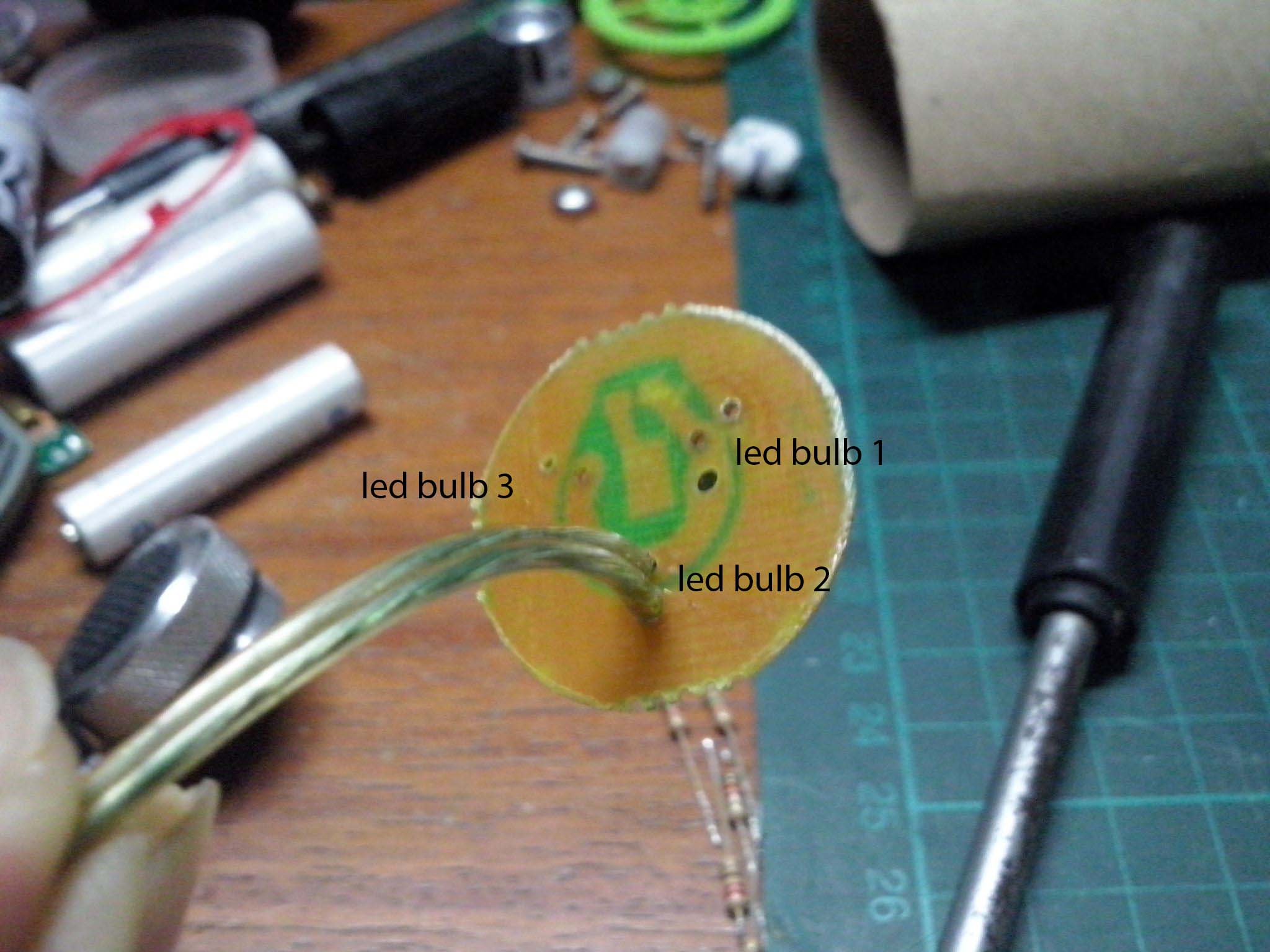

i have a laser pointer that is powered by 3x1.5 button cells. testing the batteries results to 4.5+ volts and .14A.
i want to convert it to use 3xAAA that has 1.2v and 800mA
what i've done so far
used 3xAAA with 1.2v = 3.6+ volts and 800mA
it lights up for a few seconds only
removed the power source for a minute
it lights up again for a few seconds
used 4xAA with 1.2v = 4.8+ volts and 2000mA
it blinked and did not light up again
what do i need to make it work? thanks

Some cheap laser pointers are designed to use the battery internal resistance for current limiting. Operating them with a different power supply can be tricky.
Unless you plan to make a switched mode converter, you are stuck to use at least 4 1.2V accus. The most simple solution would be a series resistor calulated for 4.5V/0.14A output (presumed your measurement is correct). A constant current circuit would be better, but difficult with only 0.3 V margin.

A button cell is tiny so it has some internal resistance that limits its maximum current to 0.14A. Your three AAA rechargeable cells (they might produce 6A) and four AA rechargeable cells (they might produce 11A) produced a current in the laser diode that was much too high and destroyed it.

think your given voltages in the pictures of post #8 are wrong. The values in the text semms to be OK.
LED: 2.65V, input 4.66V, 27Ohms
Input voltage is 4.66V, LED voltage = 2.65V, remaining voltage at the resistor is 4.66V-2.63V = 2.03V.
Now you know the voltage across the R: = 2.3V and the R = 27 Ohms. So you can calculate I: R=U/I ==> I=U/R = 2.03V/27Ohms = 0.075A = 75 mA.
The same current runs through your LED. Too much for a standard LED. It burns.
LASER: 4.52V, input 4.65V, 27Ohms
Input voltage is 4.65V, LASER voltage = 4,52V, remaining voltage at the resistor is 4.65V-4.52V = 0.13V.
Now you know the voltage across the R: = 0.13V and the R = 27 Ohms. So you can calculate I: R=U/I ==> I=U/R = 0.13V/27Ohms = 0.0048A = 4.8 mA.
The same current runs through your LASER. Maybe too low for your LASER to work correctly.
The way to go:
You need to know:
* Input voltage. Lets say 4.66V.
* Nominal LED voltage from datasheet. Lets say 2.1V.
* Nominal LED current from datasheet. Lets say 20mA
--> calcualtion of R:
Input voltage is 4.66V, LED voltage is 2.1V --> voltage remaining for the R: = 4.66V -2.1V = 2.56V
Current thourgh R is the same like current throughLED = 20mA = 0.02A
Resistor: R = U / I = 2.56V / 0.02A = 128 Ohms. Try to find the next bigger one in your stock. Maybe 150 Ohms.

oh, i think im wrong again. now i know what im going to do on the next one. ill be back after a few days. thank you all for the replies.
success!!!! its been lighted up for 30minutes
thank you klaus for making everything clear
thank you Audioguru for pointing out that everything must be computed
thank you FvM for the series layout
i just hope that it will still work if there are laser pointers connected to the 3 x AAA batteries.
bought a new laser pointer
got off initial values of .02A, input 4.51v, forward 3.78, computed resistance is 36.5ohms
but for now i got a 47.9ohm and i tried it
and it works.
question. do i still need to use 36.5ohms? or the 47.9 will do? is one better than the other since computed resistance is 36.5.
You computed a current limiting resistor value of 36.5 ohms to produce a current of only 20mA only when the battery is brand new. Its voltage and the current will drop as the battery is used.
But without seeing the spec's for the laser diode you have no idea if it will survive or whether it can safely use much more current.
The 47.9 ohm resistor you are using reduces the current to 15.2mA when the battery is new.
