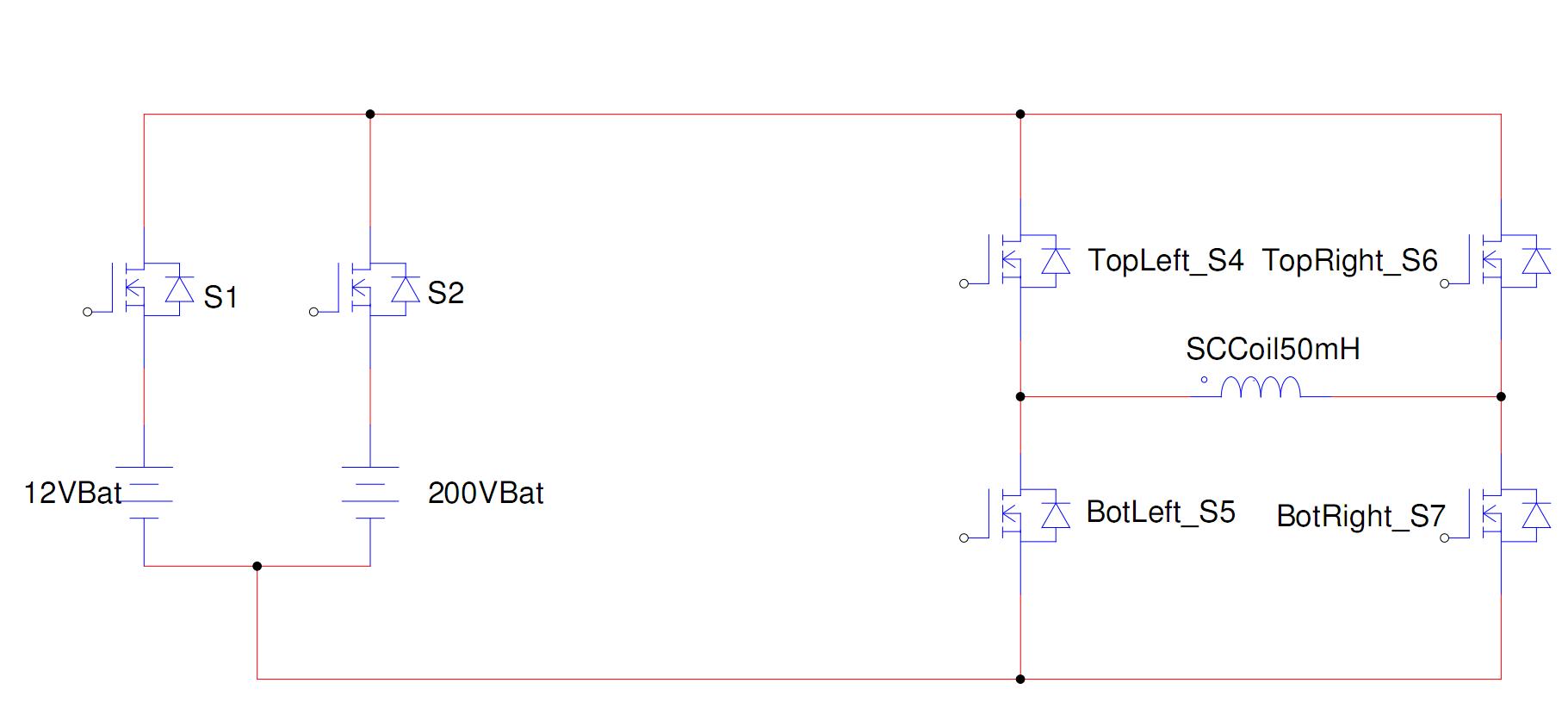

My application is that I'm using 2x MOSFETs to select between two LA batteries as the supply to system which charges/discharges a superconducting coil via a 4x MOSFET H-bridge. I've attached a diagram which shows what I mean (note, all MOSFETs are IXYS IXFK230N20T N-channel enhancement mode).
Note, the H-bridge system is already built and works fine (we super-cool the MOSFETs using liquid nitrogen and they become rock-solid).
The idea is that one of the LA batteries is 2V and the other is a battery bank running at 200V - kind of psuedo 'fast' and 'trickle' charges. The coil has an inductance of approx 50mH.
We charge to 40A and have chosen MOSFETs that can handle this with adequate cooling. Depending on the scenario and the external magnetic field applied to the coil, sometimes we a reverse current at the battery terminals and it is my fear that this will kill the 2x new MOSFETs switches I'm proposing to select between 12V and 200V battery supply.
I was wondering whether fitting an adequately spec'd diode across source and drain of S1 and S2 would protect against this.

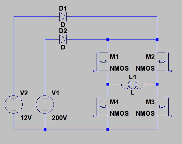

If you follow the current path through you will see that the S2 Body Source diode is always biased on feeding the 200V source to the bridge and its load. It looks like you are expecting to 'slowly' charge up your 'superconductor' to some current level and then switch it off at some 'controlled' rate of dI/dT.... or voltage... or it does not.

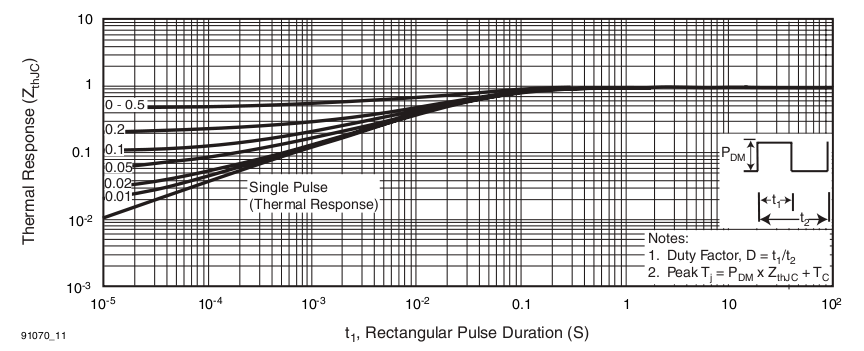

Oh, as others have mentioned the Body-Source diode is an intrinsic parasitic that results from the way the device is constructed. 'Generally' you will find it has the same average current ratings and peak current ratings as the device itself.
https://www.vishay.com/docs/91070/91070.pdf
Drain Current,
Diode Current,
There is a steady state thermal limit, wire bonding limit and a transient thermal impedance limit.
As suggested they are the same but your mileage may vary since for different devices the diode forward drop may result in different levels of dissipation.
Apart from it being a diode and having the associated characteristics if you are dealing with transient conditions then you have to refer to the transient thermal impedance curves,
Just to 'make sure' things do not audibly go 'dink'.
Then again I'm sure those curves 'do not apply' at -197C

I didn't quite follow what you meant by "If you follow the current path through you will see that the S2 Body Source diode is always biased on feeding the 200V source to the bridge and its load".
OK... think it does but it's late.
Regarding selection of the sources and your proposed circuit.. If I take out the Mosfets and just leave their body-source diodes in then the circuit becomes,
Effectively D2 puts the top of the bridge at 200V and D1 is reverse biased so the lower voltage never gets a 'look in'.
As I say the explanation makes sense, sort of. However it's late over here and I have just scoffed food so it's time for bed.

As far as I understood, you're mixing two objectives of your circuit, battery reversal protection and battery selection.
It has been already pointed out, that the circuit can't work this way. This hasn't to do with the particular properties of the MOSFET body diode and can't be healed by connecting anything in parallel. It's just a case of not considering what the circuit does.
To have reversal protection and the battery switch option, you need a bidirectional switch at least for the 200 V battery, better for both to allow power down of the circuit without disconnecting the 12 V battery. A bidirectional switch can be formed by two "anti-serial" connected FETs, preferably source-to-source, which is a usual configuration for AC/DC capable solid state relays.
When using an active switch as battery-reversal protection, which is effectively required to achieve a low voltage drop, then you have to care of course for correct control of the gate voltage. Otherwise the protection will be void.

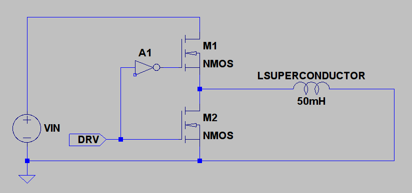

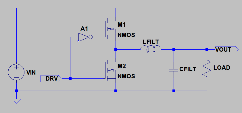

This is a picture of a simple Synchronous Buck converter,
Inductor set via M1 free wheels, or resets, through M2. The mosfets are driven in anti-phase with duty cycle setting the output voltage. In simpler converters M2 would just be a diode and, as you can see, the body source diode of M2 would behave as such. They 'are' generally rated to do this, as long as it says so on the data sheet, but as others have mentioned the characteristics of the diode unless the device is processed correctly is nothing to write home about.
In the case of synchronous rectification when free-wheeling current is flowing through the diode the Mosfet is switched on, the drain channel is resistive and current can and does flow through it in both directions. With the Mosfet on then the majority of the current flows in the Drain with a resulting lower voltage drop and reduced power losses in the circuit.
Of course.... if you do this,
Then things might begin to look 'familiar'.
It is a 'perfectly acceptable' thing to do as long as you apply 'current mode control' to the power switches and with correct sensing you would be able to set the current quite precisely. The question would be do you mind 'high frequency' voltage excursions at one end of your coil and the associated 'ripple current' in it?
Keeping things simple then there is a 'soft' limit to how high VIN can be. Basically you can get level shifted drivers rated up to 100V that would do the job quite nicely. You can go higher but then control of things like cross-conduction becomes more of an issue.

Is the attached diagram what you had in mind? If so, should I use individual isolated gate controllers? Finally, do you turn them both on at the same time when you want +VE current to flow to the system then turn them both off to isolate the battery?

Whilst your email on the Sync Buck was really helpful and informative, I couldn't quite work out how this relates to making the battery-selection switching part work. As I mentioned earlier, I'm a total noob with regards to power electronics and only have limited experience at normal electronics, so my appologies if I'm appearing fairly stupid.................

The bidirectional MOSFET switch is correct this way. Please notice, that for on-off control, both gates can be connected to a common isolated circuit, driving a voltage between the gates and the common source nodes. As mentioned, you can buy AC/DC solid state relays, that either have a DC/DC converter or a simple (slow switching) photovoltaic optocoupler to isolate the control signal.

The synchronous buck would not solve your battery selection problem and I was 'hoping' that the AC problem wasn't there. OK, I was pushing my luck. As suggested the synchronous buck would have given you very precise control of the current from 0 up to your 40A and would have maintained the 'holding' current to similar levels. Instead of switching batteries you would just let the feedback deal with things and used a single high voltage source. Given AC is a real issue, I sort of did not doubt it but.... then it looks like that was and is a no go. On top of that you also want the bi-directional drive and, in a similar way, your full-bridge might have done the same.. but AC is a problem so that won't work as well.

I must admit to not fully understanding why it can handle both forward and reverse current.
I assume, you fully undestood, why a single FET can't handle it. Because the diode enables current in one direction without a means to stop it. Now, in off-state, the current flow will be blocked by one of the FETs having a positive Vds. The other will conduct above 0.5 to 0.7 V. In on-state a MOSFET will have it's low rdson for both current polarities. The switch resistance is however doubled, because both MOSFET's rdson is summed.
Will this finally be the solution that enables me to control whether the 12V battery or 200V battery is supplying the H-bridge?
Yes. But you have to care to interlock both battery switches, otherwise theres a danger to short the batteries.
