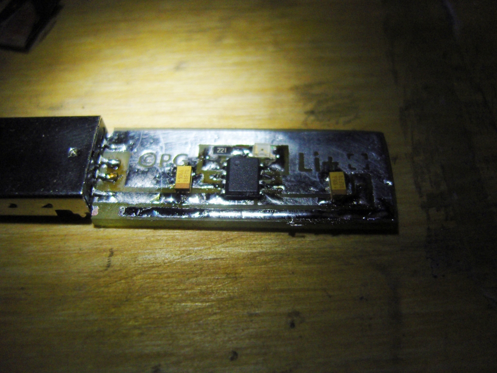

First drafts of the board were moved to the computer, then printed on laser and ironed.
After that, rough cutting, etching and then tin.
Next, soldering the USB, chip, signalling LED, resistor and two tantalum capacitors (10uF/10V).

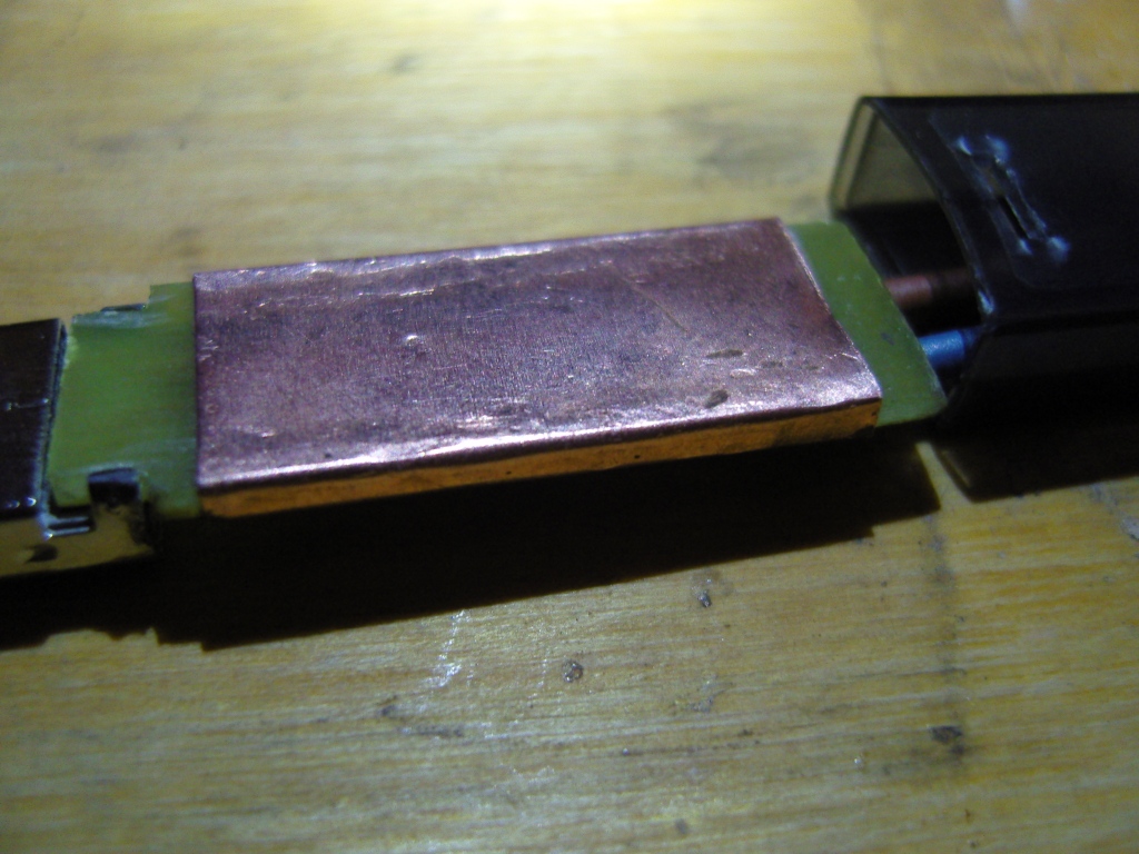

The system sheet recommended that the mass occupied as large area of the plate as possible, because it also serves to heat dissipation from the system. Additionally, a thin copper plate was soldered to the board and wrapped under it.
The board was locked in the housing from a wireless mouse receiver. The outputs for the charger are ultimately alligators, which will be connected to the basket with a cell, or on magnets in the case of non-standard batteries.
