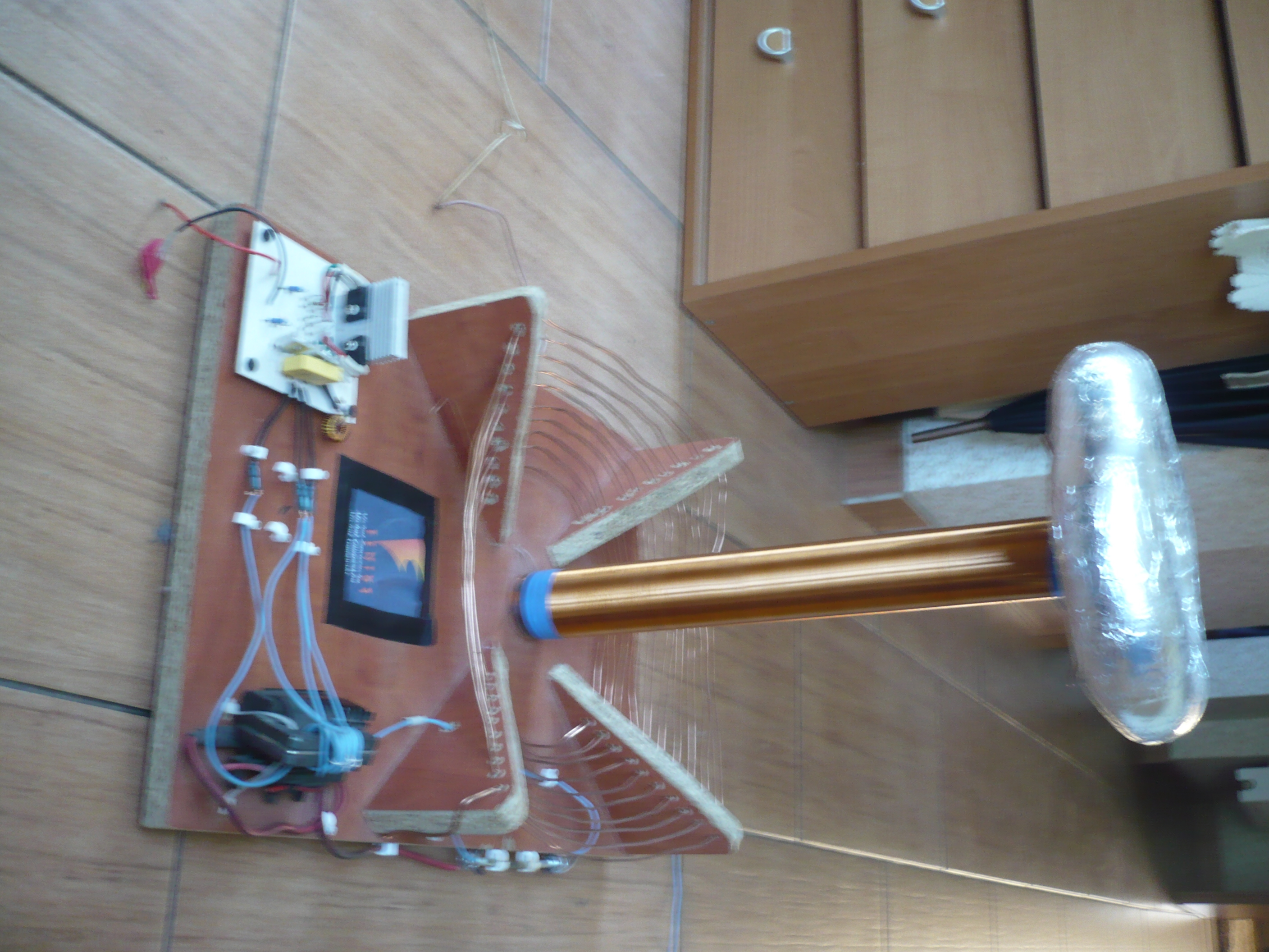

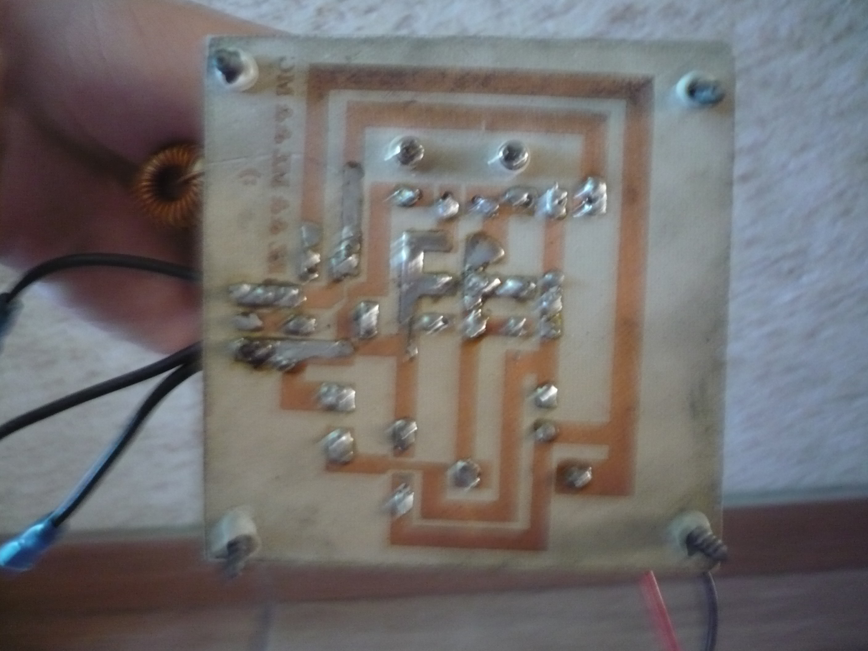

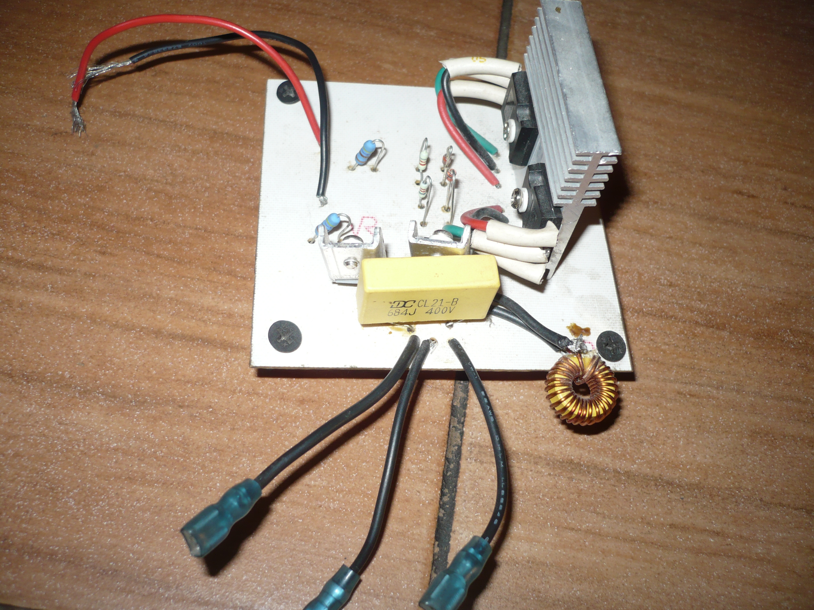

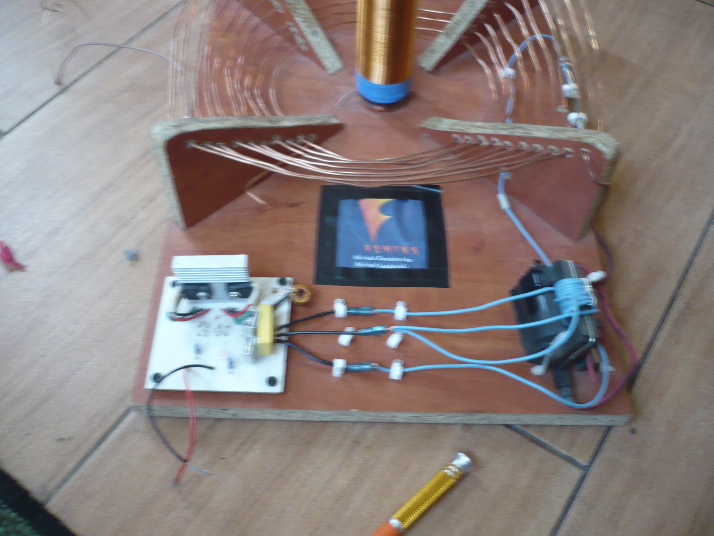

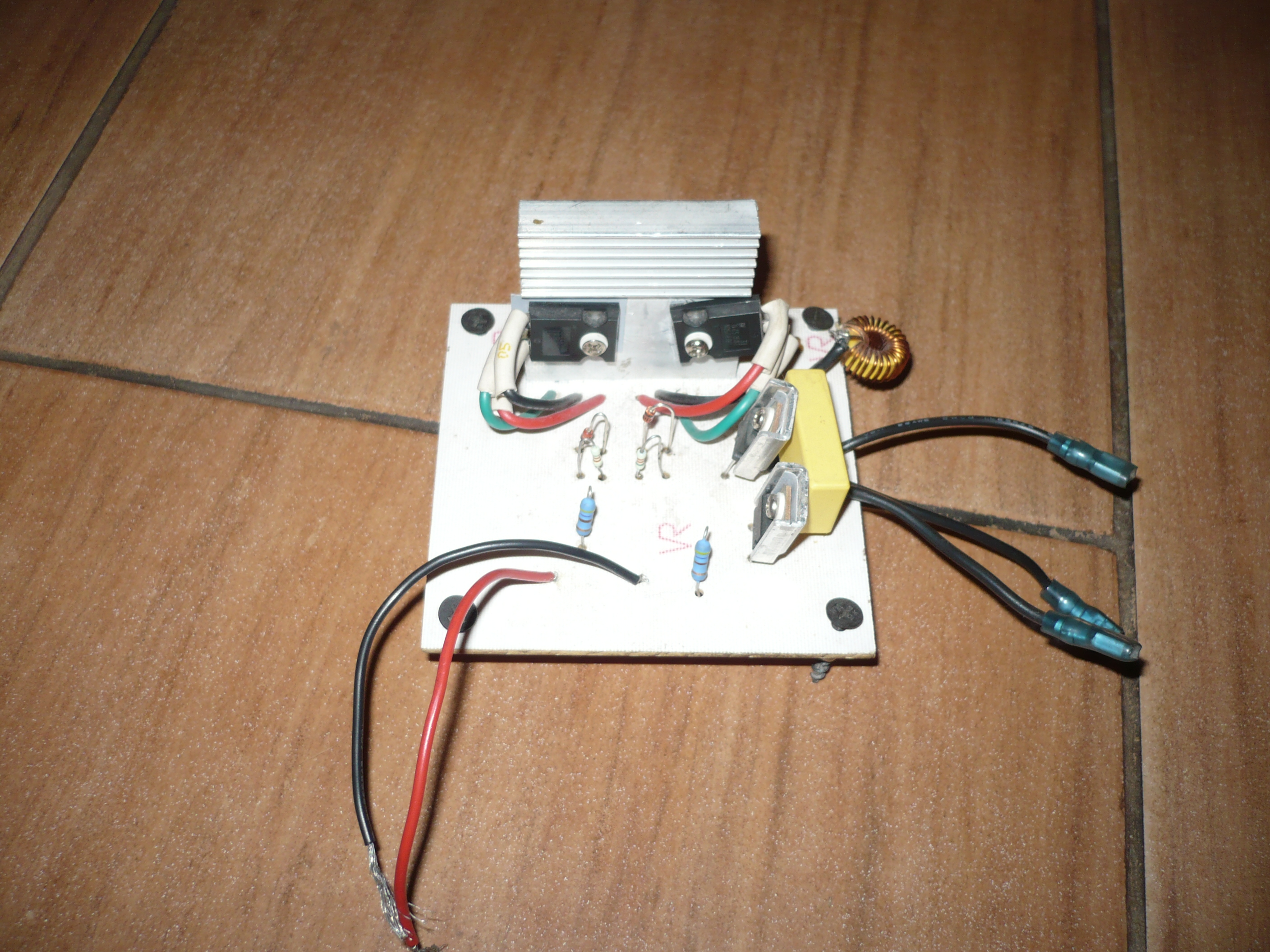

Tesla transformer was built on inverter ZVS Flayback Driver. It is powered by 12V to prevent the capacitor from being damaged.
PARAMETERS
Main:
  • Power: about 144W (Rectifier power 25V, current: 6A)
  • Voltage: 35000V
  • Intensity: 0,0058A
Primary winding:
  • Type of winding: saucer
  • Thickness of wire: 2mm
  • Initial winding diameter: 19cm
  • Final winding diameter: 40cm
  • Resonant scroll: 5-6
Secondary winding:
  • Diameter: 5cm
  • Height: 38cm
  • Winding wire thickness (without enamel): 0,20mm
  • Number of turns: about 1700
Toroid:
  • Outside diameter: 20cm
  • Diameter of the tube used: 6cm
  • Capacity: about 13pF (farads pico)

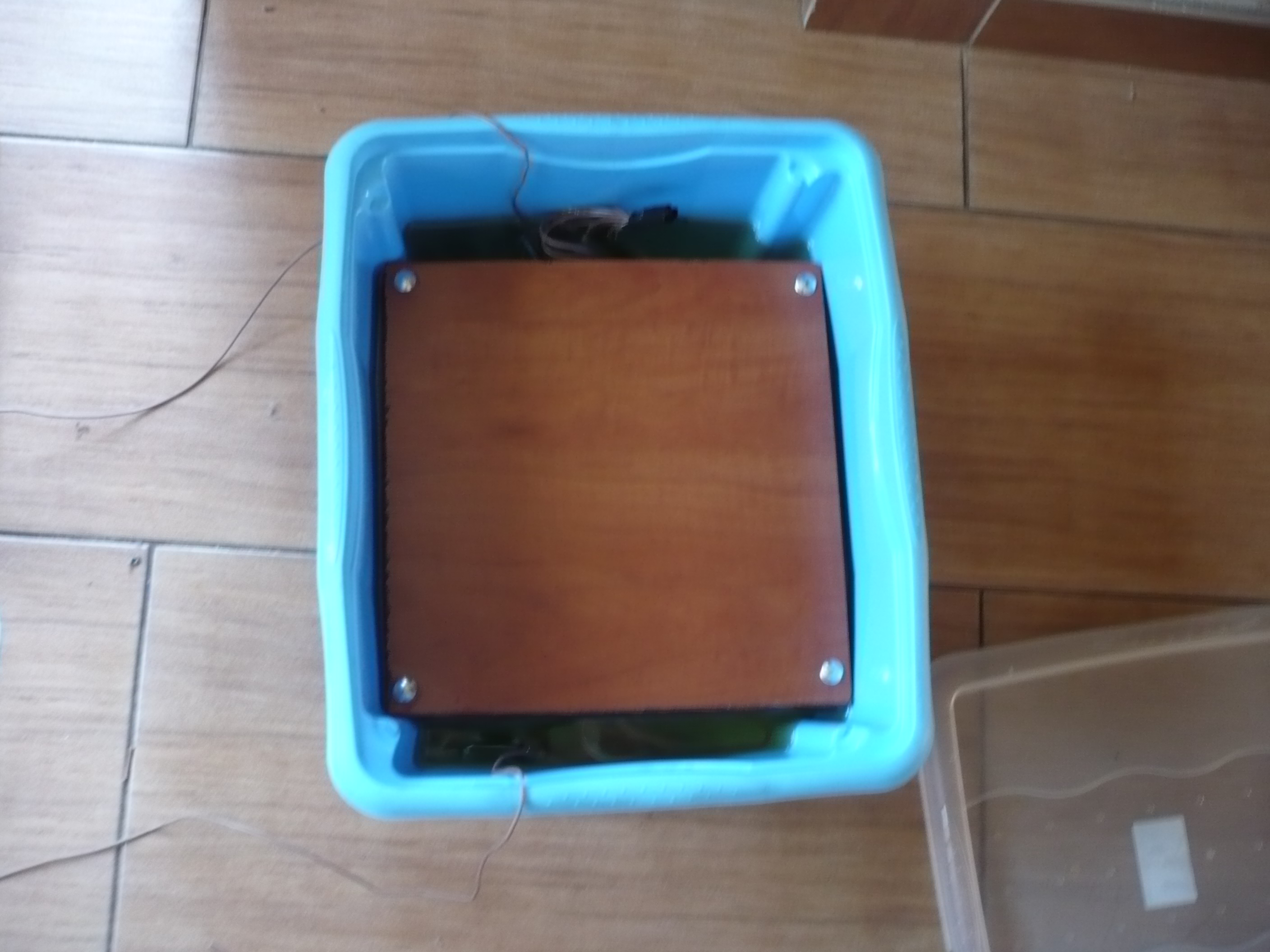

WN capacitor:
  • Aluminum foil width: 20cm
  • Aluminum foil length: 20cm
  • Dielectric (polyethylene) width: 25cm
  • Dielectric (polyethylene) length: 25cm
  • A single dielectric foil thickness: 0,1mm
  • Number of layers of polyethylene film of the dielectric: 15
  • Number of layers of aluminum foil: 20 (which gives 10 capacitors connected in parallel)
  • The dielectric constant of polyethylene foil: 2,4

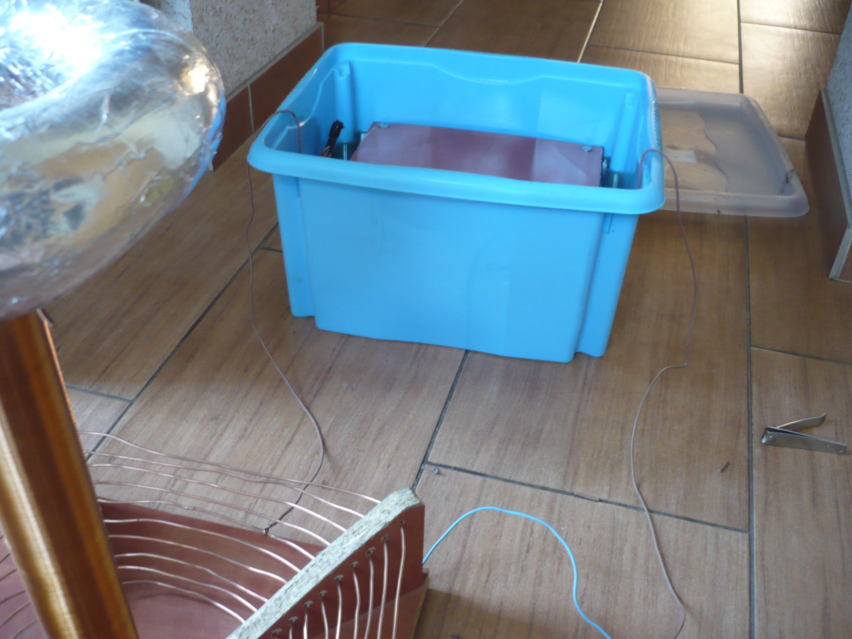

  • * Cuvette, to which capacitor was inserted, was flooded with 8 liters of vegetable oil
Capacitor: 11,5nF
Max voltage: about 35000V
