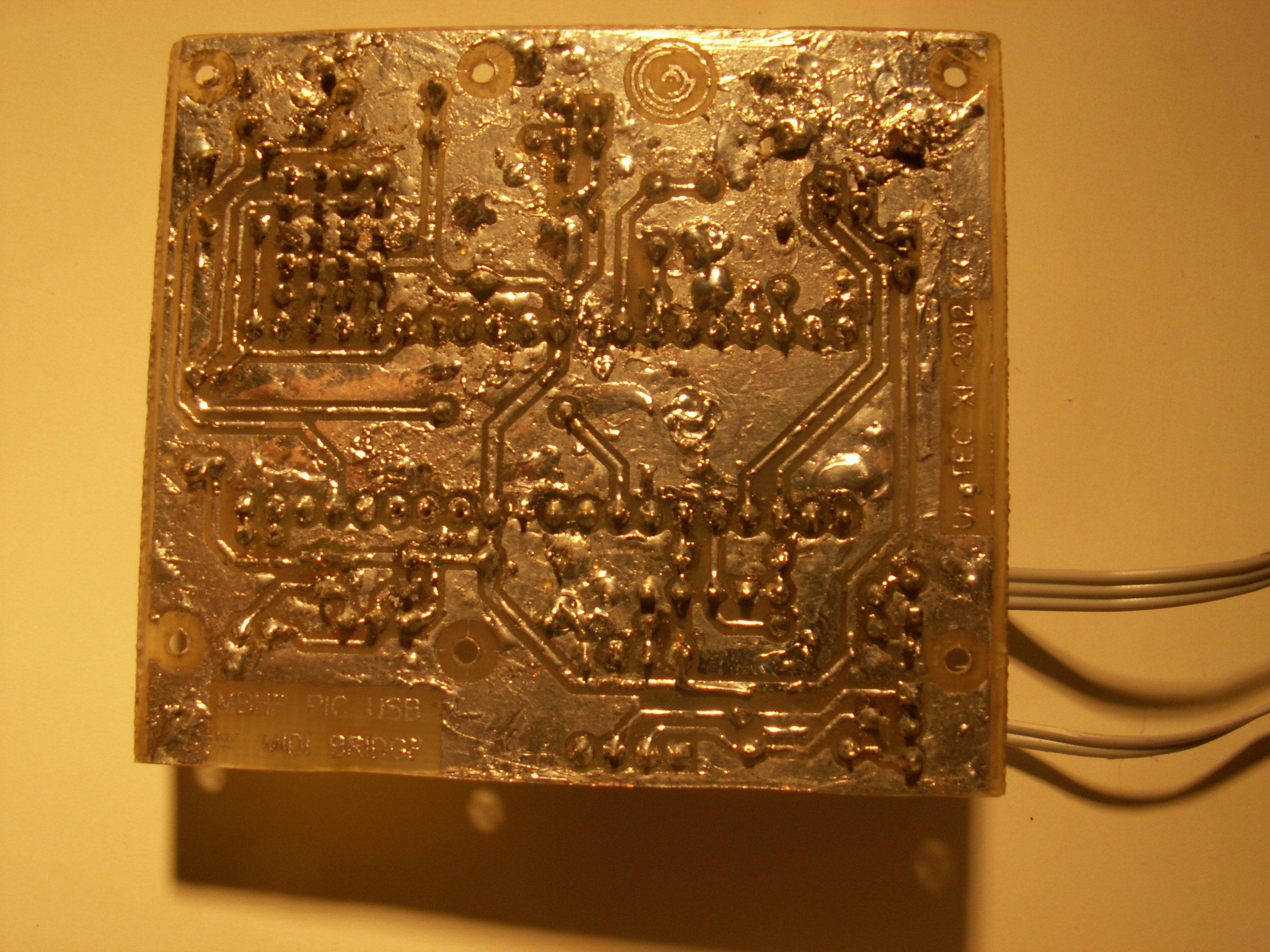

Prototype:
The board is slightly different from these pictures (especially near the optocoupler) due to the fact that it was incorrectly designed. It was necessary to solder two cables, cut two paths and a small jumper. All the holes were made using 0,6mm drill, and then some of them were enlarged using 1mm drill. Mounting holes were made using the 2mm drill for metal.
