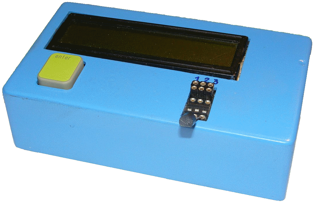

This device is a tester for semiconductor elements. An inspiration to built it was article by Markus F. and his prototype of tester, that i found at German web.

Brain of construction is microcontroller ATMEGA8, 3 transistors, voltage stabilization 7805 and few diodes , RC elements.
Power supply adaptor or 9 V battery. Tester need about 45 mA while testing. Such big value is because flash diode and display. After 10 seconds device turn to stand by mode.

so i have made it great tool here is my picture with modified hardware also for latest firmware and source code go here
