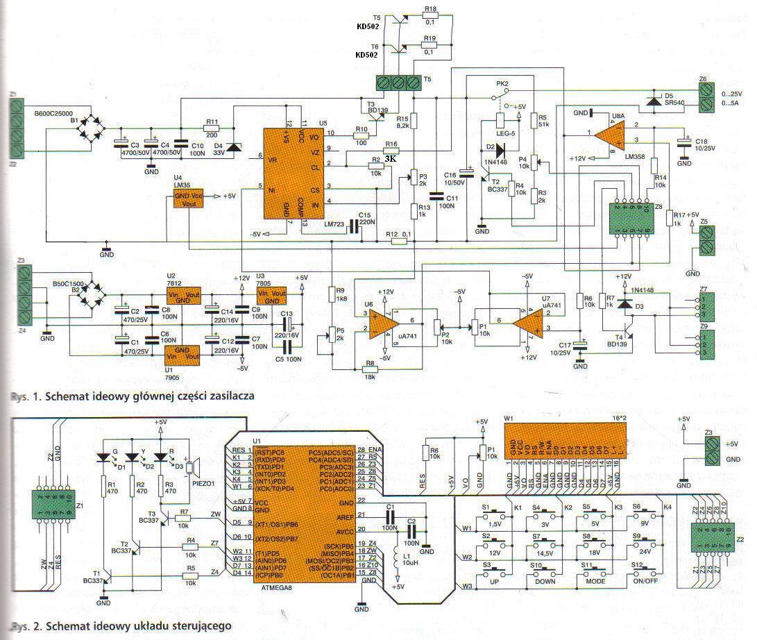

This power supply is based on a microcontroller. It hasn't got any potentiometer, current adjustment is made by 12 impulse buttons. 8 of those control the tension, one disconnects the output, the next button is used for changing the option between adjusting the current limit and an indication of the actual power consumption. The last 2 buttons are used to smoothly adjust the current and tension.
The R16 resistor should be about 3K instead of 10K!
