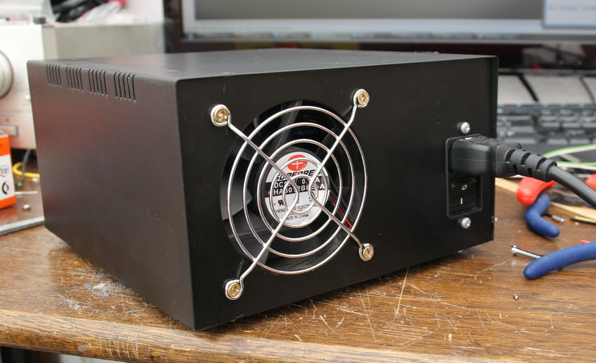

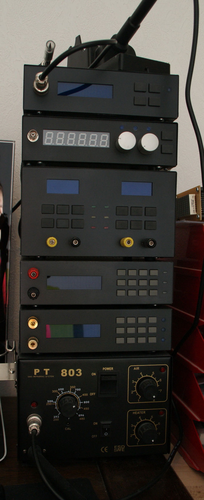

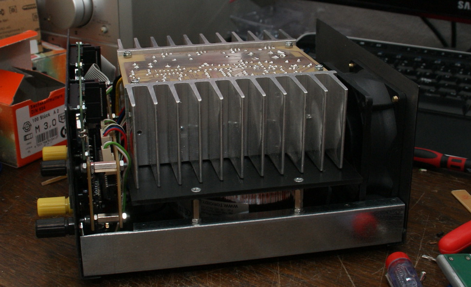

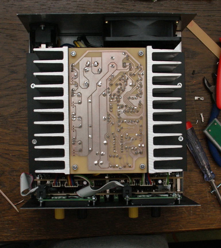

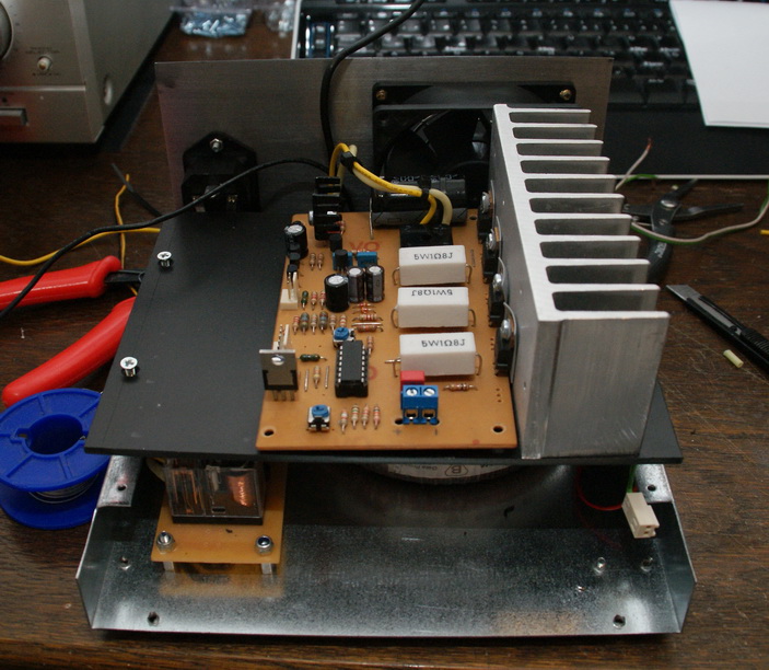

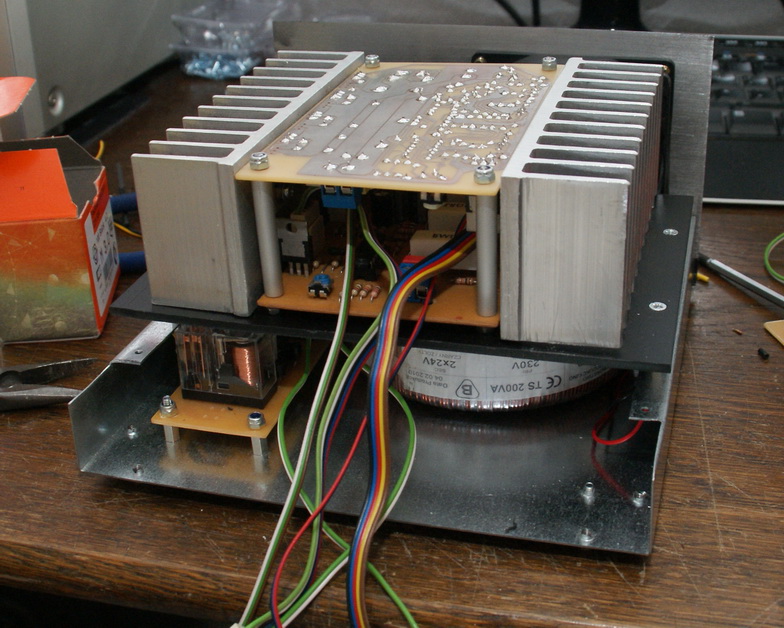

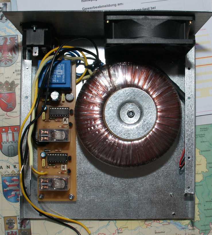

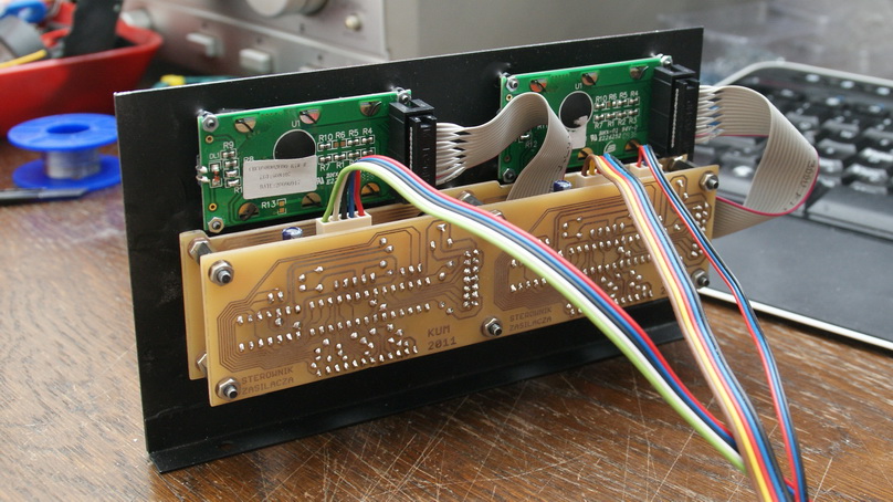

It is a microprocessor power supply of own production. An original driver of Nord Elektronik was used in the construction. Then boards were implemented.
Silicone pads under the transistors act as isolation. The power supply controller is based on Atmega8.

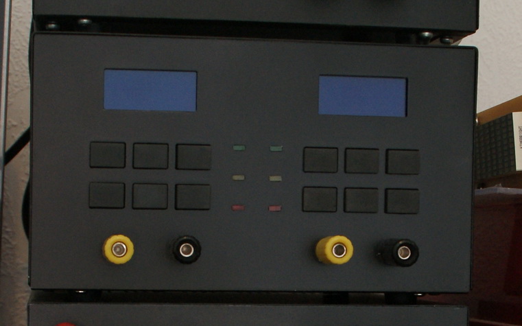

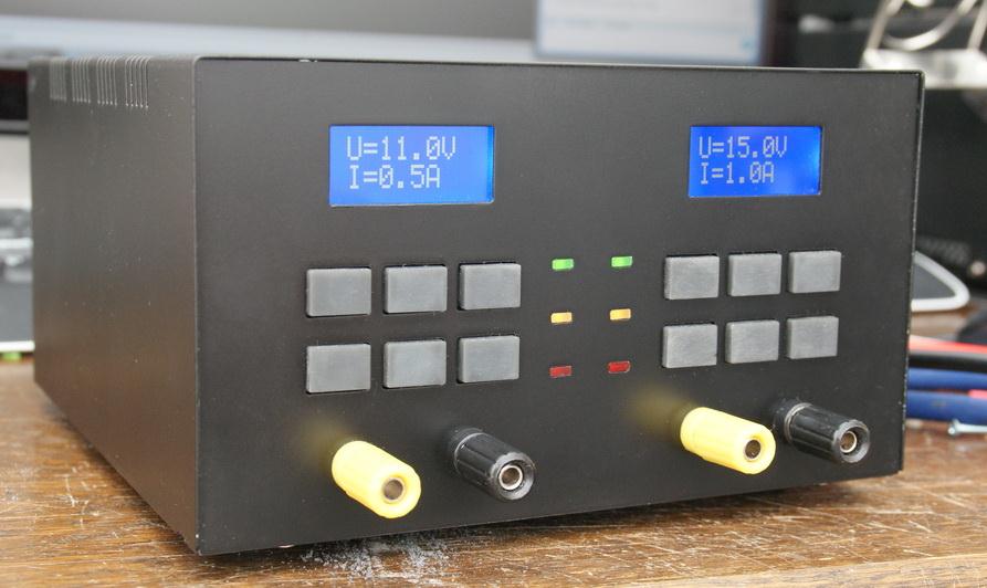

The power supply works excellent. When properly tuned, the precision reached is 0,10V and 0,10A. The device is used as a symmetrical power supply.
