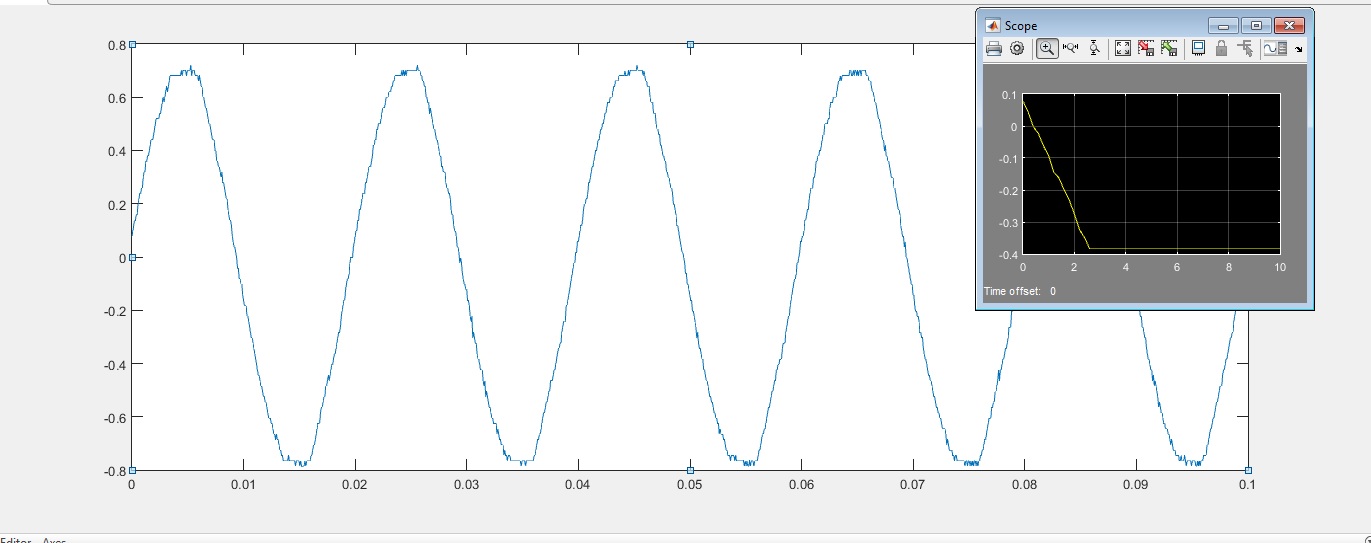

Hello everyone.
I have got a signal using digital oscilloscope from the mains 230V.
I plotted the data: time vs volt using matlab and i got it. However, when i tried to plot the same data using From my space in simulink I got different shape and its not even a wave form
I had two parameters in my workspave which are time and volt and then i used
ts = timeseries(volt,time); to get the two parameters in one matrix
please have a look at the two waveforms from plotting tool in matlab and from scope of simulink
the original wave form maximum amplitude is 0.8 Volt and the neasuring time -2.5 to 2.5 a total of 5 seconds
I have zoomed in to get a better clarity.
Regrads.
Your diagram at right appears to be a small portion of a sinewave, namely the part where it crosses zero and goes into the negative region. Did you set it to zoom in on that narrow timeframe?
No i havent. This is what i thought so ,,tried to zoom in ,,nothing changed
Do you see more of the waveform when you zoom out? I think that's what you should try.
Experiment with running time so it's long enough to see a few sinewaves?
Show simulink model. If you expect sine wave form, then simulink is the problem.
time from -2.5 to 2.5 ? How comes that ?
