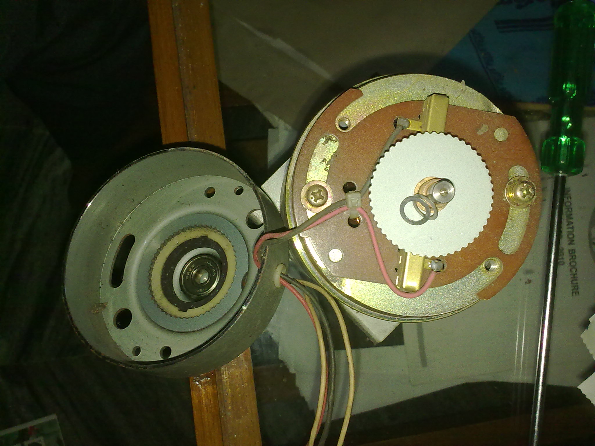

Can anyone help me building a Magnetic encoder interfacing circuit ?
Magentic encoder is connected to behind of a DC motor , how can i interface it with uC using H-bridge and count the steps ?
hall effect sensors and magnet bar combination is used for Magnetic Rotary Encoder System.
magnetic encoder out put
simple program to read direction and count

Is there any interfacing (amplifier) circuit needed for connecting it to uC ?
The sensor has two leads each from each bar.

these are the photos of motor with the magnetic sensor ,
This sensor doesnt need any amplifier ?
The motors with the sensors as the above pic's sensors will work with the amplifier circuit as Jestin_cubetech suggests ?
