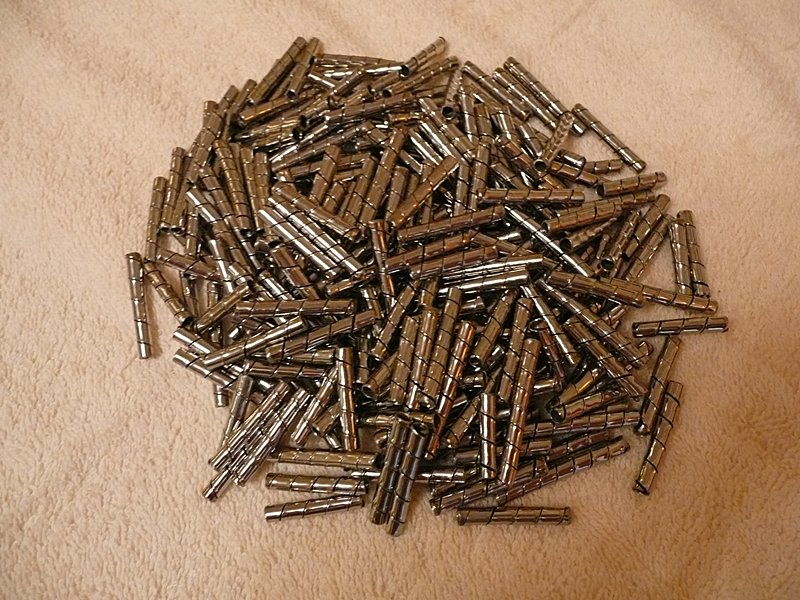

User Sławek61 made a luminous decoration for any room. The whole thing is made of an acid-proof structural steel sheet (orange peel), Plexiglas and natural cork. The leaves were cut with a manual guillotine, then polished, grooves were cut with a Dremel device and then polished. The bottom was made of 8mm Plexiglas. The stems of the leaves were made of the strips of an acid-proof steel sheet rolled around a fi 4mm bar and cut into pieces of different lengths and the whole was polished. In each leaf, there is a diode glowing depending on color, connected in a range of 8-10 pieces, 24V-supplied, cables hidden under the cork and this all is assembled in a tree form to the wall or a painting. The effect is wonderful, the biggest tree has 250 pieces of the leaves. They are mainly used during TV watching.
