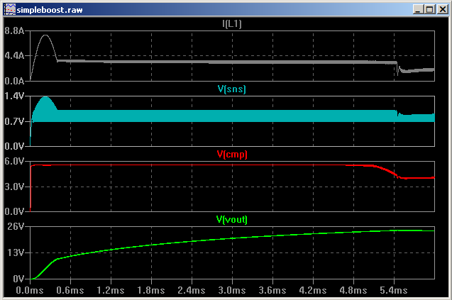

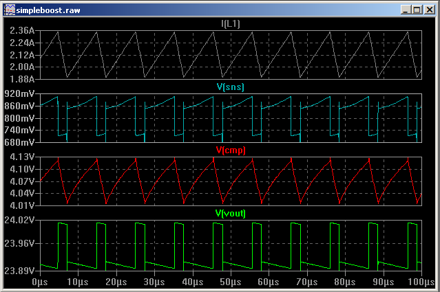

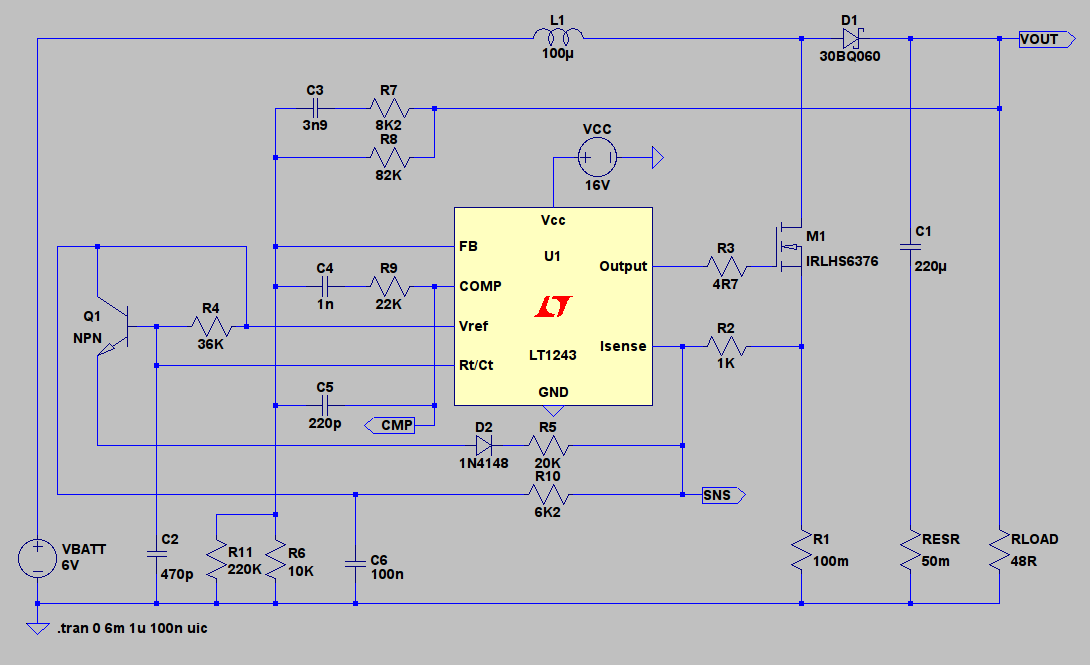

Jumping into LTSpice,
Linear Technology - Design Simulation and Device Models
This is not an exact representation since the suggested components are not available in the package.. it does show the basic set up though.
The LT1243 is 'similar' to the UCC3803.
Q1, D2 and R5 supply the slope compensation. During switch off time the current downslope is 18V/100u converted to a voltage of 18,000 in the sense resistor. Half that is 9K. In the LT1243 the ramp amplitude is 1.7V and with Fs at 100K we get 170K so we have to attenuate it by about 20 giving a value for R5 of 20K. R10 offsets the signal to match the internal 1V peak limit of the IC.
Apart from the compensation the rest is more or less as previously described. I'm afraid I've been evil and 'guessed' at values in the feedback network to get something that 'works'.
Start Up,
In regulation,
Output power is 11.93W. Input power is 12.73W. Losses are 0.8W, better than expected but the diode is a Schottky and the Mosfet is specced with a lower RDSon, 93% efficient. Depending on the models LTSpice might underestimate some of the switching losses.
