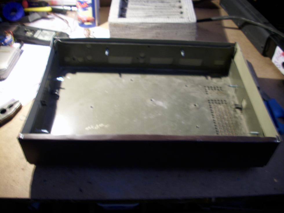

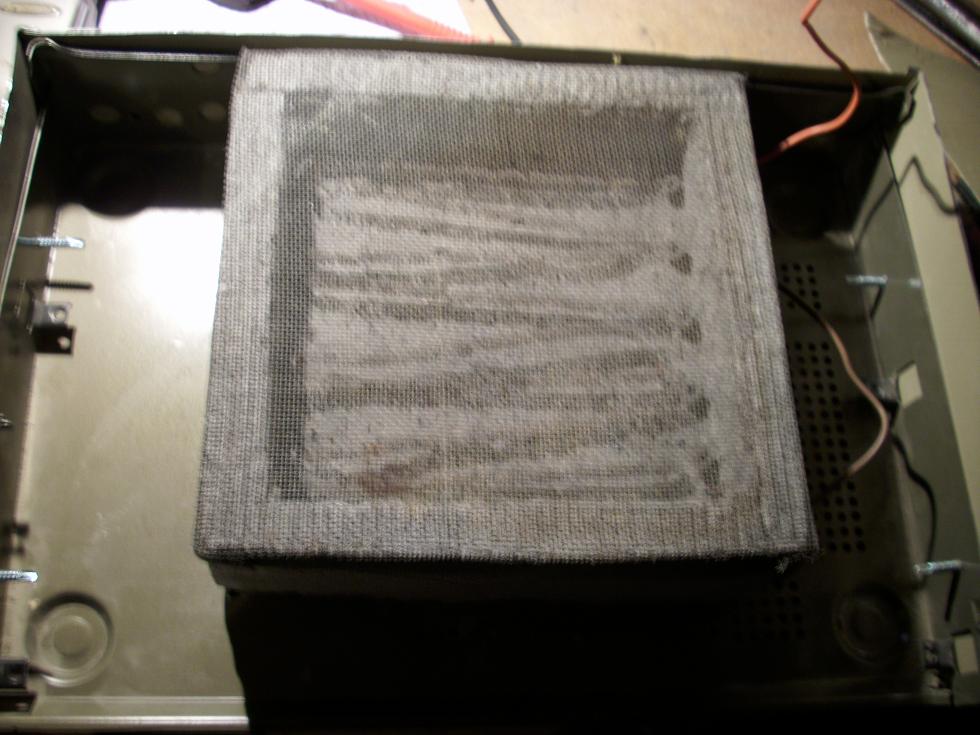

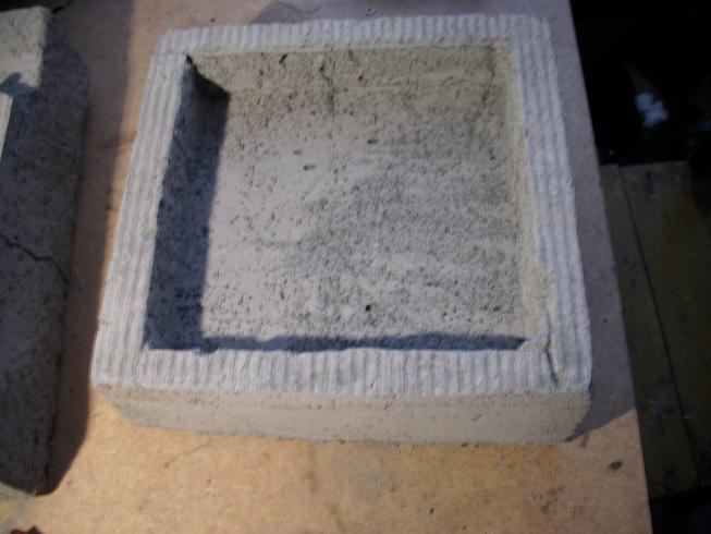

Made up of spiral after some old electric heater, with 700W. spiral is placed in channel that is rut in building block ( aerated concrete) because it’s great thermal isolator and it’s easy make.
Casing:
Is a bottom part of decoder

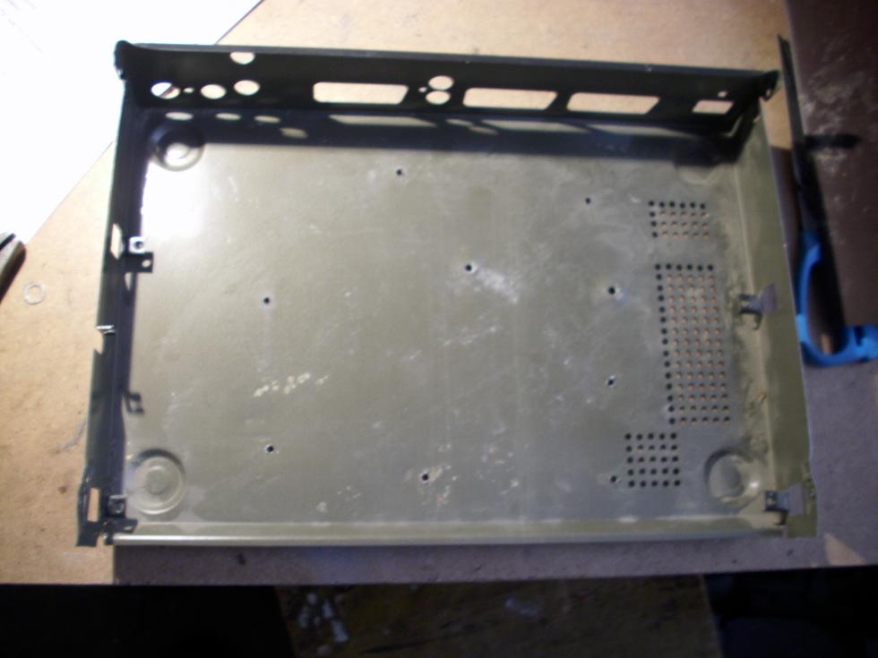

Casing:
Rest of casing made up of metal sheet
Spiral is evolve on screws. Net is made up of steal screen.
Grounding
Power cable is 3 phase, connect to casing by switcher, net is also connect with casing at back side. For safety reasons this kind of protection should be made!
