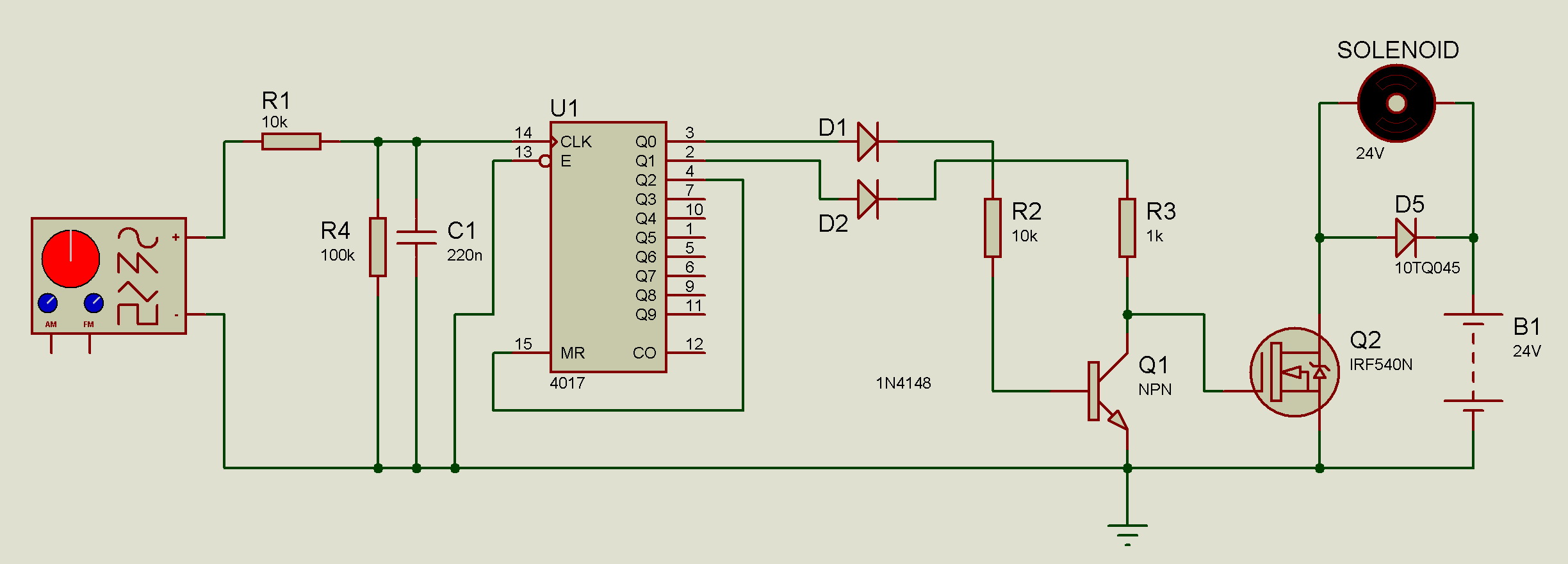

I am working with a 24VDC system and need to actuate a solinoid valve every 2nd time that I get a signal. We dont have a PLC so I am trying to do it with relays. Does anyone know of a way to do this or another componant that may be helpful? Any and all help is greatly appreciated.

It is bistable. Example: Pulse 1=on, Pulse 2=off.
If you dont want to use relays, here iis a simle solution.
Bistable operation
Bistable operation with skipping pulse

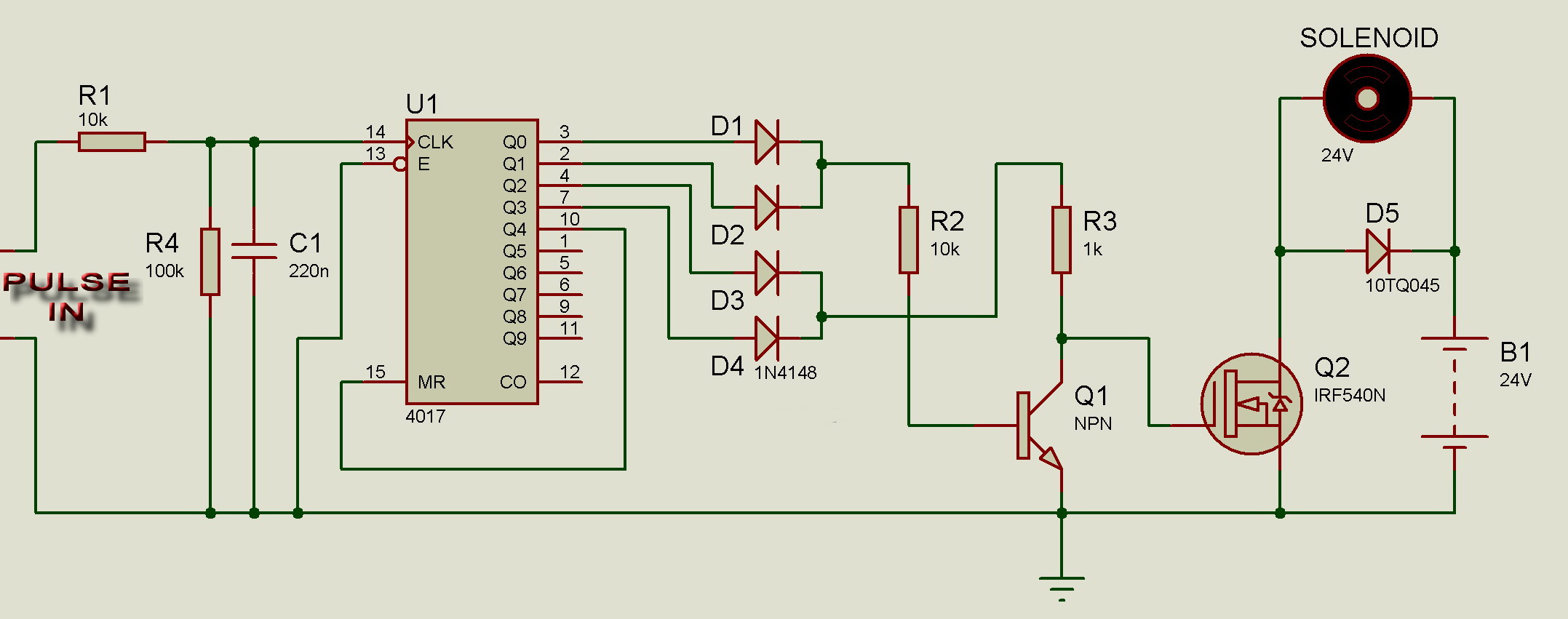

Alertlinks, These look a little out of my league for right now however i would love to learn all about this. Will the second one acctually work like a flip flop?
Both circuits work like flip flop. The difference is,
The first one work like this.------ Pulse1->on. Pulse2->off then repeat------
The second is--------- Pulse1->on. Pulse2->No action. Pulse3->off. Pulse4-> No action then repeat------
