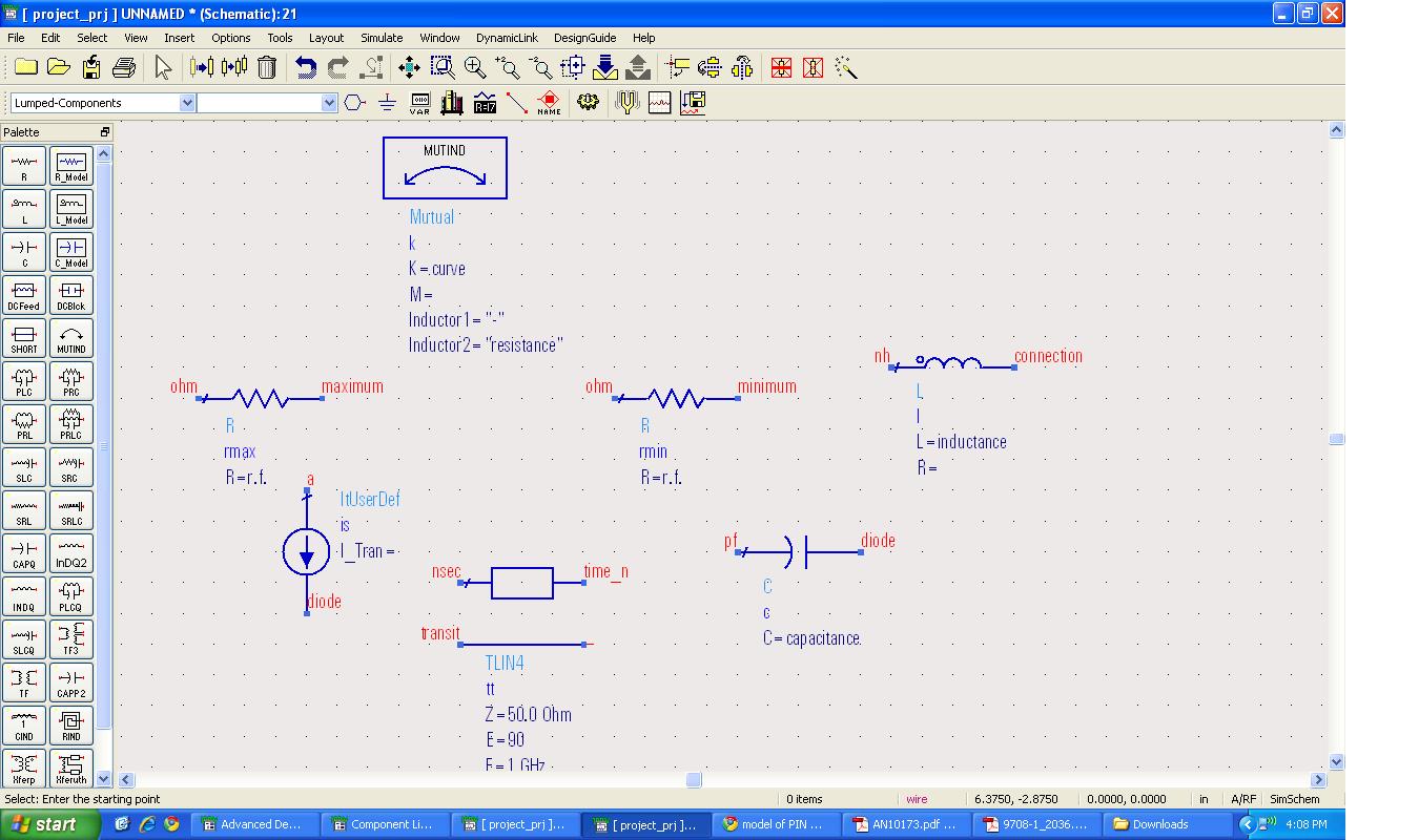

I also need a model for pin diode.I found this link HPRFhelp version 2.12
When I copy the text into a text file and import a model in ADS,it gives these things( attached in figure) which I don't know how to use or interconnect because there are one or two things in the generated model I don't understand.Can anyone help me please. Its very urgent.
