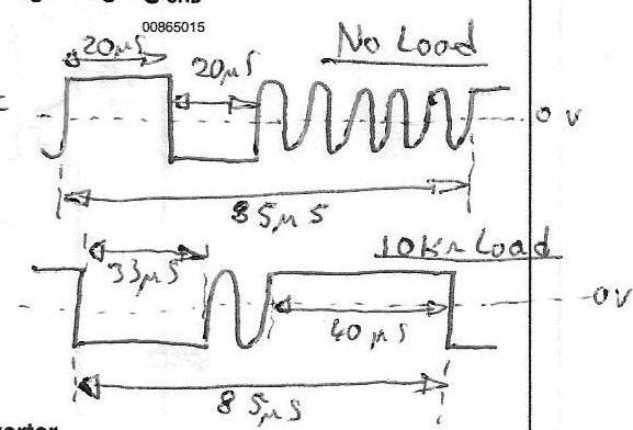

The measured Vo is -12.04V with no load or a load of 10k ohms, however if I try to draw more current the output voltage collapses.
I've looked at the junction of Q1,D1 and L1 with an oscilloscope and I get approx 12V for 20uS, approx -12V for 20uS then sinewave for 45uS (approx 5 full waveforms), then repeated when no load is applied.
With 10k ohm load I get approx 12V for 40uS, approx -12V for 33uS then sinewave for 12uS (approx 1 full waveform), then repeated.
I've not worked with switch mode power supplies before, so am unsure as to what I've done wrong. Any help would be appreciated.

Show us what the waveform on the cathode of D1/collector of Q1 looks like, before and after the voltage starts drooping. Sounds like it's going discontinuous but the large variation in duty cycle you describe implies something else is going on.
Also make sure the polarity of the output bypass capacitor is correct for negative output voltages.
Below is the waveform - I'm not sure what is causing the sinewaves.
The sinewaves don't quite go as low as the lowest negative part of the waveform and for the one not under load the sinewave magnitude gradually decreases.

Those sine waves are normal. It means your supply is operating in discontinuous mode.
I've found one definite issue in the datasheet though. The device is limited to about 45% duty cycle operation. That would easily explain why your voltage is drooping when you apply a heavier load. You're reaching that duty cycle limit.
That doesn't really explain the inductor heating though. That's still a mystery.
