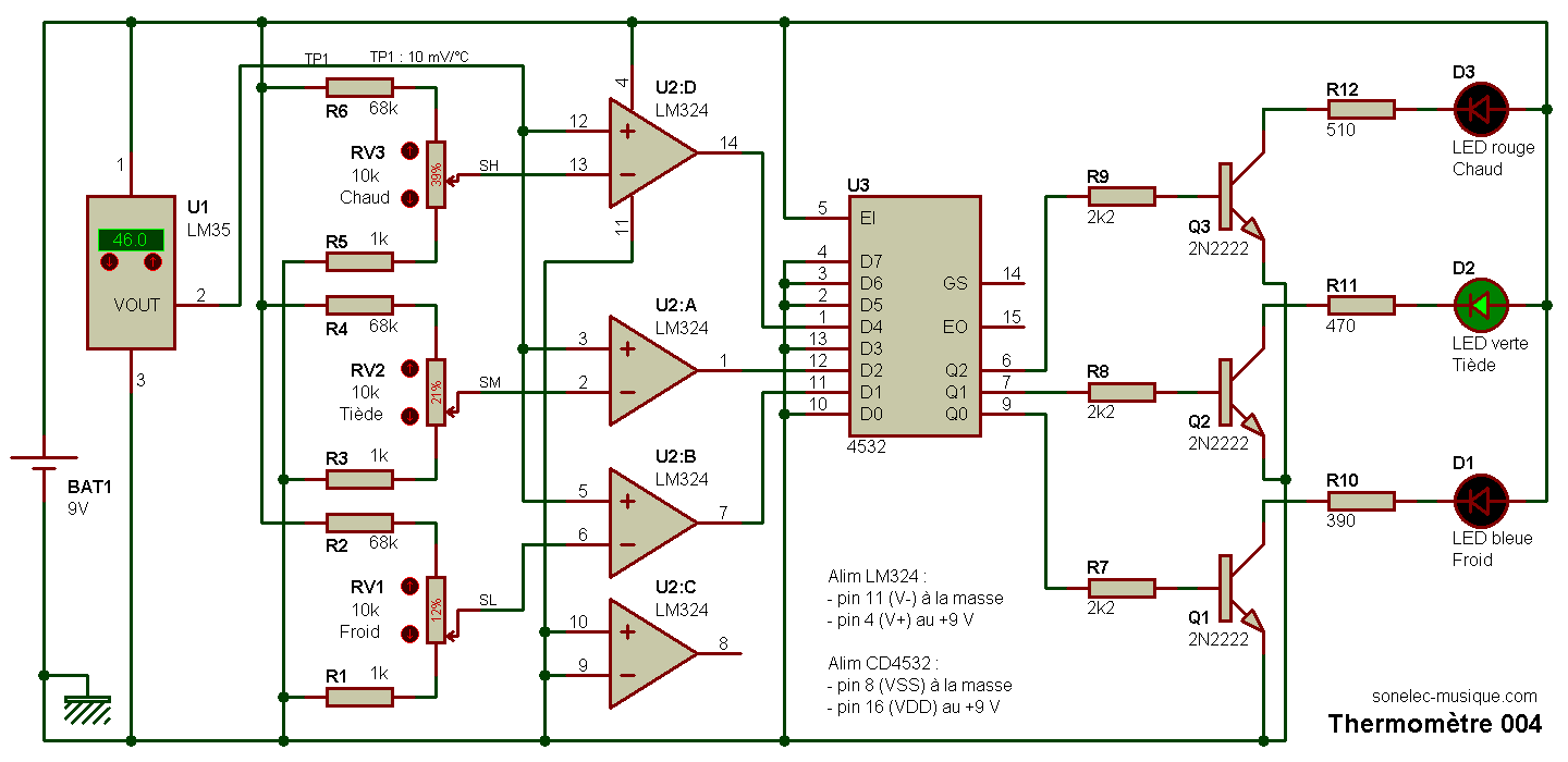

Hello,
I have a couple of projecs on the go.
I have a LM35 and i want 3 LEDS to run at different temperatures IE.
Blue LED AT 10C
Green LED AT 30C
RED LED T 60C
The output from the LM35 is 10mv 10C.
Im struggling to make this circuit, i hve found one using a Arduino but i dont want to use one
