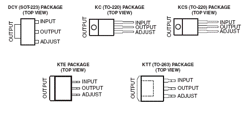

I have solderd up this circuit.
Vin = 24V
R1 = 1k
R2 = 10k or 12k or 8.2k or 8.2k + 4.7k in parallel.
It doesn't matter what I do with R2 I cannot get Vout below 20V

Never mind, I just realised what I am doing wrong.
I had assumed the pinout was the same arrangement as the fixed voltage regulators which I have been using up until now, i.e. input on the left, output on the right and common, or in this case adjust, in the middle.
Just looked at the datasheet and realised the pinout is totally different.
The circuit diagams in the datasheets are arranged in the same manor as for the fixed voltage regulators which re-inforced my incorrect assumption.
One again that's what happens when technical people write user manuals - they make assumptions about the reader's experiance level. If it were up to me I would arrange the LM317 symbol with a pinout that reflects the pinout of the actual device.
It works better if you look at the datasheet before you build the circuit.
Seriously? You're blaming the guy who wrote the datasheet because you didn't bother to read it?
The whole point of writing user manuals is to make them idiot/Greg proof!
This isn't idiot-proof enough? It's at the top of page one:

I finally got the prick of thing to work with a steady output of 17.65V after I put in all the protection diodes in. It has taken me a week of extremely late nights to get this figured out, among other household tasks of course.
For some I just couldn't get that circuit diagram in the datasheet sorted in my head while transposing it to a circuit board due to that inconsistent LM317 symbol.
But now that I have done it once, perhaps I will find it easier next time. :smile:
No doubt I am having the same problem with the DC-DC boost converter I have been trying to solder. Ahhh well I will get it sorted sooner or later - I am not ready to quit on it yet.
You can never assume there's a connection between the symbol and the pinout. For example there's only one symbol for an NPN transistor, but it is common for different transistors to have different pinouts even when they are in the same package.
