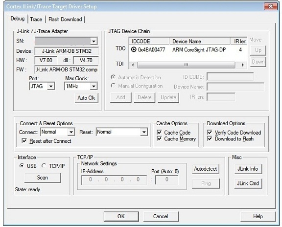

iam using j-link usb-jtag and keil uvision 4.70.0.0.
thank you.
The starter kit you buyed don´t have library or example programs to do access to flash memory ?
j-link and target memory settings for lpc1788 with 32MB 32bit SDRAM,8 MB NOR FLash, 128MB NAND FLASH
// image array
const unsigned short _acimage_1[] __attribute__((at(0x8000000))) = {
***JLink Error: Could not find CFI compliant flash device Target system has not enough RAM.
