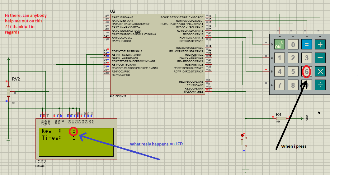

keypadcodes problem with pic 18f45k22 plus LCD together with codes
mnyama
Feb 23, 2013
1,333
hi there, i got the problem here, my intention was just to interface 4by4 keypad on pic 18f45k22 with mikroc code, but the problem is, i am not gettin on the lcd what actually it has been placed on the keypad, observe carefully the diagram below
or
https://obrazki.elektroda.pl/1023693100_1373969007.png
here, are the codes,

unsigned short kp, cnt, oldstate = 0;
char txt[6];
// Keypad module connections
char  keypadPort at PORTC;
// End Keypad module connections
// LCD module connections
sbit LCD_RS at LATB4_bit;
sbit LCD_EN at LATB5_bit;
sbit LCD_D4 at LATB0_bit;
sbit LCD_D5 at LATB1_bit;
sbit LCD_D6 at LATB2_bit;
sbit LCD_D7 at LATB3_bit;
sbit LCD_RS_Direction at TRISB4_bit;
sbit LCD_EN_Direction at TRISB5_bit;
sbit LCD_D4_Direction at TRISB0_bit;
sbit LCD_D5_Direction at TRISB1_bit;
sbit LCD_D6_Direction at TRISB2_bit;
sbit LCD_D7_Direction at TRISB3_bit;
// End LCD module connections
void main() {
 cnt = 0;                                 // Reset counter
  Keypad_Init();                           // Initialize Keypad
  ANSELB = 0;                              // Configure AN pins as digital I/O
  ANSELC = 0;
  Lcd_Init();                              // Initialize LCD
  Lcd_Cmd(_LCD_CLEAR);                     // Clear display
  Lcd_Cmd(_LCD_CURSOR_OFF);                // Cursor off
  Lcd_Out(1, 1, "1");
  Lcd_Out(1, 1, "Key  :");                 // Write message text on LCD
  Lcd_Out(2, 1, "Times:");

thanks, in regards
MikroC KeyPad Library
https://www.mikroe.com/download/eng/documents/compilers/mikroc/pro/pic/help/keypad_library.htm

Did you try this outside Proteus, such as breadboard for example ?
Best regards,
Peter
