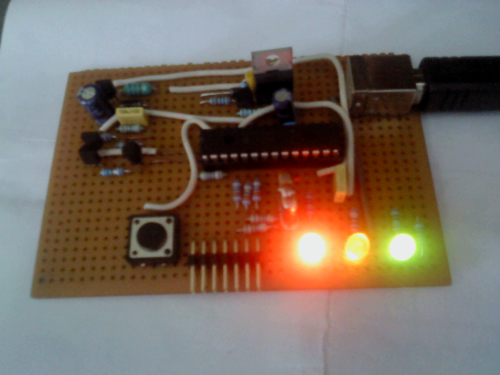

i made a pickit2 clone...it's working fine...i am happy......
but i made it in general purpose PCB...
see this picture at different states.......
