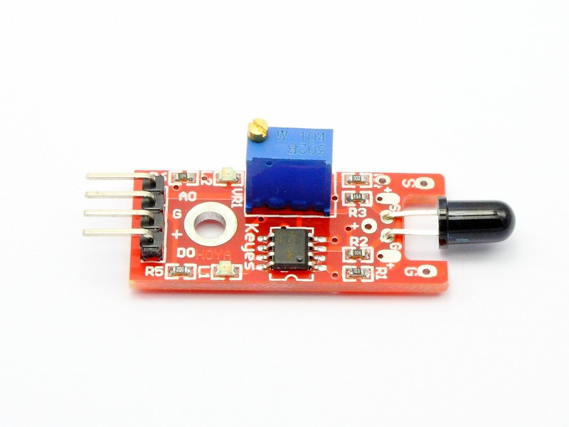

Hello,
May I obtain your recommendations on a design suitable to detect a flame 10 meters away?
Our objective is to find an infrared photodiode or phototransistor for a fire-prevention product.
It needs to be able to detect a hot stove element ten meter away (with or without a fire on it),
while at the same time yielding the maximum dynamic range and accuracy for faraway heat sources.
(i.e. hopefully the microcontroller ADC can determine if a candle 10 meters away is lit / unlit with great precision)
Our research on fire has led me to the conclusion that carbon-based fires emit the most infrared rays at an average 4.3 um.
Is an IR detector at that range possible, while keeping a very tight budget (hopefully under 0.30$).
Any other information is appreciated as well, thanks!
A thermopile or microbolometer will do it, but sadly they are not cheap.
Maybe open up a non-contact thermometer? Otherwise, Farnell sell ZTP-135S which
should work (I've not tried it).
If the heat is coming from a stationary source, you might consider using two thermistors, one in a lens pointing at the source, the other close to it but not in the lens to take the ambient reading. The difference between them would indicate that heat was being produced and may be able to measure how much.
Brian.
You can experimentally find the best IR element to use. As you need to detect IR radiation from a flame or a fire over ~10 meters distance, you need a suitable IR telescope (instead of a lens use a small parabolic mirror (the bottom of aluminum Coke can works well). To get the required sensitivity, I would add a mechanical modulator (a rotating wheel with holes or gaps) to interrupt the incoming radiation. To detect a fire alarm, you can use an audio amplifier and speaker which will sound if a fire or high heat is detected.
Many years ago I built such simple device, with two photodiodes (one as a reference), an audio opamp feeding a transistor switch that operated as a synchronous detector. With a small propeller (3 cm dia.) as the modulator I could hear and measure IR radiation from a bulb or a hot iron over >10 meters, and light from street lights over one kilometer.

my pal photo diode works on the intensity of light falling on it and not on IR rays falling on it
next the current of the photo diode is in the order of micro ampere so additional current amplifiers are required
photo transistors also produce current for diverse intensity of light but in the milli ampere line
if you are going to detect IR better go for thermo piles and stuff they are more help ful
The parabolic reflector idea is a good one. I stress I have never tried this but I think a thermistor should be adequate. Photo diodes are fine when a fast response time is needed but they are more expensive and as mentioned they only produce a tiny output which needs amplification. A physically small thermistor will have a reaction time of only a few seconds and its output can be quite large if wired in a potential divider circuit. They are also immune to light of course.
I would experiment and see if further filtering is needed, you may find the difference between heating and igniting is big enough that they can be reliably distinguished.
Brian.
I like the UV TRON by Hamamatsu as it senses a flame without expensive filters.
You can test a pocket IR thermometer, but try to find one with an analog output. I tried EXTECH but only OMEGA IR thermometers also have the analog output to indicate a flame.
Those IR thermometers utilize a thermopile or a PIR sensor and their response is slow, ~ 1...5 seconds. Also thermistors are slow in response.
Photodiodes are fast in response, and allow the chopping as I described. THe chopper disk alternates the ambient and target temperature to hit the sensor by an audio frequency. So the output is an audio signal which is easy to use to trigger a fire alarm.
MOst other sensors are slow and too much affected by te ambient temperature, drafts, etc.
