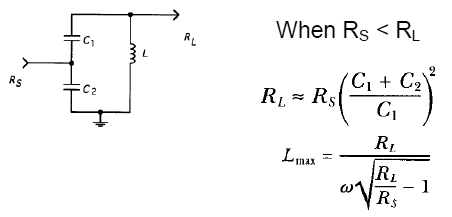

Hello
How to calculate the input circuit (C1, C2, L2, L3) for certain frequencies?
Thanks a lot!

You should know the input impedance of the IC to obtain their values at certain frequency.
When you have a resonating loop, then you use the formula for frequency, based on values for L & C.
C1-C2 are equal, and in series. So their effective value is 1/2 of C1.
The ratio of L:C is important.
The aim is to create voltage swings which are great enough for the IC to detect. Volt levels should be within the recommended range for the IC.
Large voltage swings are associated with large L, small C.
Another factor is the amount of power coming from the antenna. If available Amperes are low, then you'll want larger L, smaller C.

You can use the equations in the image below. This is valid only for resistive source and resistive load.
The upper limit of L is when C2 is not required, while at low L/C ratios the circuit becomes sensitive to small component value changes.
As a general rule, L must be smaller than Lmax but not much smaller.

You give the IC input impedance as 4k. You do not want this to load your LC loop too much. Therefore make your LC loop have a much lower impedance, say 1/10 of that. Then a suitable impedance for L and C might be 400 ohms.
Calculate what L value has 400 ohms impedance at 21.7 MHz.
Then calculate what C value has 400 ohms impedance at 21.7 MHz.
These only give you approximate figures. The parallelogram angles are the correct method to apply. However the L and C cancel each other's phase differences, so you should be okay.
You may not have sufficient antenna signal for a 400 ohm impedance. You may need to amplify the incoming signal.
