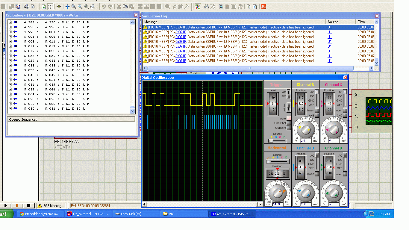

Hi guys,
I finished a code for I2C..when i stimulated in proteus..i2c debugger shows error message is "DATA written in SSPBUF whilst MSSP(i2c in matermode) data has been ignored"
But written data shown in i2c debbugger..here i attached images..
and written data is 0x05 in debbugger viewed as 0x50..
and if send a string how it's possible...

I think storing of bits in the address is the problem.. check whether MSB or LSB is receiving first.

Can you post your code plz

hi guys
my data is 0x05
when i seen in debugger 0x50...i doubt with,whether data is written or not...
below this routine for main()
void main()

You must share the code for i2c_init,i2c_address and read the error may be in the configurations and also include a delay of 50 - 100 ms in between i2c_read and disp_data.

kindly debbugg it soon,,,,,

which is your i2c slave device? Is it an eeprom?
