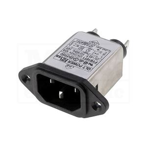

Does this EMI filter hase built in NTC resistor?
https://www.tme.eu/en/details/fyb10t1/iec-60320-connectors/yunpen-electronic/

I will use this filter
I don't know whitch NTC resistor value to use?
I don't know whitch Fuse value to use?

I will buy EMI Filter, NTC resistor and Fuse.
