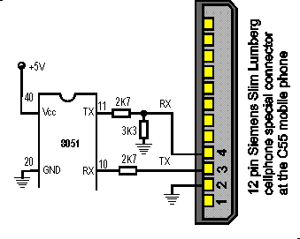

hi friends.
I am trying to send sms with 8051(89c51rc2)and siemens C55.But I failed.I dont know why.When I try to send sms,cellphone turns off.
My schematic and C code here.where is my mistake.I dont know.
Also I can send sms by hyperterminal with data cable.And I simulated it by proteus succesfully.And it is project to pass the class.Plz help me firends.
that is my schematic:
https://obrazki.elektroda.pl/10_1208886865.jpg

Are you sure about the pin numbers of the phone to which you have directly connected the controller pins? How did you manage to connect to these pins of the phone? Unfortunately, my Tinycad is not able to open your cable diagram, may be due to version difference. Since your phone is working with PC, it would have been easy to connect your controller to the same cable through a MAX 3232 chip on your controller board and bringing out the signals on a 9pin male connector exactly matching the pin connections as per PC's connector.
While I have not yet fully gone through the document, assuming the phone pins are correct, your TX connection to the phone will give problem. The R6 resistor which you have connected with a good intention will reduce the voltage level below required Hi level since TX output of the controller is from a high pull up resistor. You can remove R6 and connect a 3.6 V zener there, with anode to ground. Also, since the phone output is already low, you could remove the resistor in the the controller's RX path.

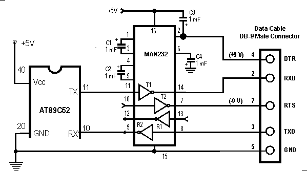

your first advise is using max232 then db9 connector and data cable?
second advise has a problem tx,rx connection.How will I do redraw my schematic.Can you draw.I didnt understand.
please help me...
I was asking you how could you connect to TX/RX pins of the phone without using a data cable.

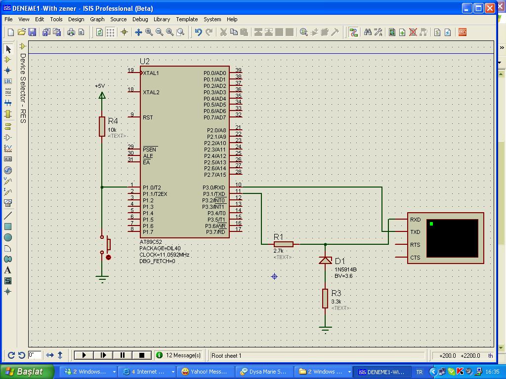

The data cable you used to connect the phone to PC has an RS232 voltage coverter to change the TTL levels of the phone to +/-12V levels used in RS232. So I was suggesting you to use such a level converter on your microcntroller board and using the same data cable connect microcntroller pins after MAX232 to the phone.
However, if you are sure of the pins of the phone presently connected, then I thought you could as well try that also without going back to the above suggestion of using the data cable. In this case, you have used an R6 resistor, shown in your JPEG diagram, in the TX path of the micrcontroller, which reduces the TX signal very much. You should replace it with a 3.6V zener diode and see if your present set up works with this change. If you find it difficult to understand, please take the help of a local Electronics guy, as therwise I find it difficult to communicate.

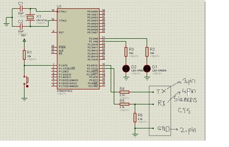

You have still not answered my question as to how you have idetified the pins of the phone and how you are connecting directly to those almost invisible pins. The cable would have taken care of all those problems and bring out a proper signal to match with the connector of the PC, whose pins are clearly defined. If you make any mistake in idetifying the pins of the phone or in direct connections to those miniature pins, it may cost you the phone.
Now as regards the new schematic, you need to make the following changes:
1. R3 is not required, short across the pins of R3.
2. Connect the ground of the micro controller to the ground of the phone.
Otherwise, it appears ok to me.

ok.I have done what you said.And my code is correct?.And I have another schematic.
this is my new schematic that is you said me...
I have another schematic with max232.
8051------>>>max232----->>>DB9male coonector----->>>Data cable(data cable has a female connector) siemens C55.
my another schematic is here:
