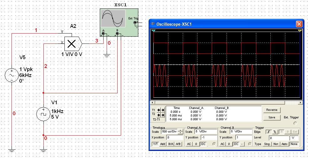

i need an ASK Modulation circuit diagram =D

we have an assignment to look for different ASK circuits. And then we'll try it in Multi-sim (workbench) so that we could see the output.. please help. thanks =D
@krishnag
This is ASK modulation using a multiplier.
There is still another method by using OOK(on/off keying) or switching.
Just rearrange the circuit since we have the same teacher.
