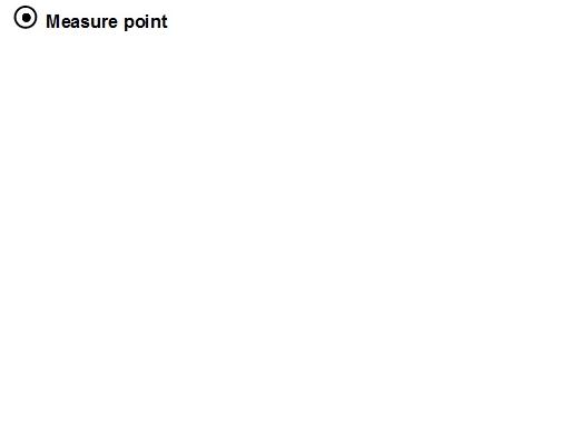

Oct 26, 2011 #6 D dineshdeshmuk Full Member level 5 Joined Sep 12, 2011 Messages 285 Helped 18 Reputation 36 Reaction score 18 Trophy points 1,298 Activity points 3,131 kak111 said: First check IC type and pinout from datasheet. A circuit for testing Op_Amp IC`s. **broken link removed** Click to expand... thanks a lot can i test any type of Op-amp IC with this testing circuit ? what these points are in this diagram ? https://obrazki.elektroda.pl/29_1319651493.jpg can you please specify the IC's pin nos. in these testing circuits diagrams ? thanks

Oct 26, 2011 #7 kak111 Advanced Member level 4 Joined Mar 30, 2011 Messages 1,365 Helped 933 Reputation 1,868 Reaction score 909 Trophy points 1,413 Location Finland Activity points 10,827 can i test any type of Op-amp IC with this testing circuit ? Click to expand... Yes , all normal types what these points are in this diagram ? Click to expand... Point for measuring output signal with voltmeter or scope. can you please specify the IC's pin nos. in these testing circuits diagrams ? Click to expand... Look 3 small pictures for standard pinouts. Pinout can vary by different types so allways check from datasheet These are the pins in test circuits............

Oct 27, 2011 #8 D dineshdeshmuk Full Member level 5 Joined Sep 12, 2011 Messages 285 Helped 18 Reputation 36 Reaction score 18 Trophy points 1,298 Activity points 3,131 kak111 said: Yes , all normal types Point for measuring output signal with voltmeter or scope. Look 3 small pictures for standard pinouts. Pinout can vary by different types so allways check from datasheet These are the pins in test circuits............ View attachment 63320 Click to expand... in the diagram you provided the 5 pin configuration of an op-amp but the part has 8 pins , so , for what the remaining three pins are ? thanks, great reply though

Oct 27, 2011 #9 alexan_e Administrator Joined Mar 16, 2008 Messages 11,888 Helped 2,021 Reputation 4,158 Reaction score 2,031 Trophy points 1,393 Location Greece Activity points 64,371 dineshdeshmuk said: in the diagram you provided the 5 pin configuration of an op-amp but the part has 8 pins , so , for what the remaining three pins are ? thanks, great reply though Click to expand... The opamp on question is a dual opamp chip, there are two pins which are the common power supply and three pins for each of the two opamps (+input, -input and output) . Refer to the datasheet of post #2. Alex
