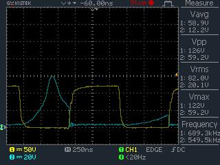

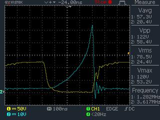

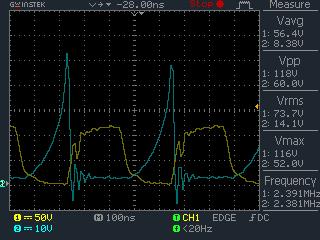

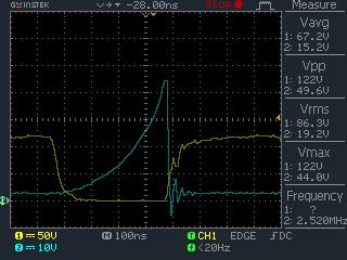

Here, I am attaching the waveform for Soft-Switching.
https://obrazki.elektroda.pl/3986004800_1361790341.gif
Yeah, you're way off from ZVS. Might want to double check that all your component values are at least close to what your simulation uses. But from that plot it looks like your off time is at least a factor of three too short.

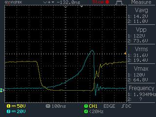

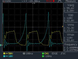

Hello FvM/mtwieg,
Except the MOSFET, I have used the same component values which I have used in the simulations. Do you think that due to the MOSFET the hard switching problem may occured? If you so, what I suppose to do to over come this problem. By the way, how to calculate the parasitics in the circuit?
I have drive the circuit with specifications of operating frequency-3.4MHz and duty cycle-50%.

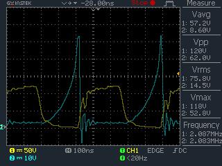

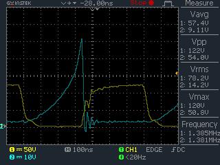

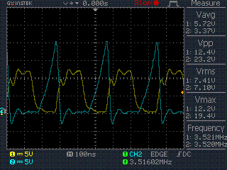

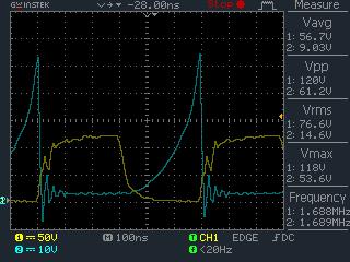

The number 1 waveform indicate that the drain signal and number 2 waveform indicate that the gate signal. I can't able to capture the drain signal with in the oscilloscope screen because of the high voltage at the drain terminal.
https://obrazki.elektroda.pl/1526893500_1361878556.jpg
It's possible that the FET has different junction capacitances than the simulation, which would throw off the waveforms. Or parasitic capacitance in your transformer.
You should just try adjusting the frequency and duty cycle until you get proper ZVS operation, then show us what it looks like.

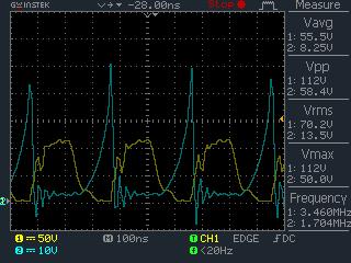

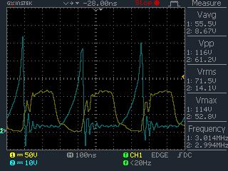

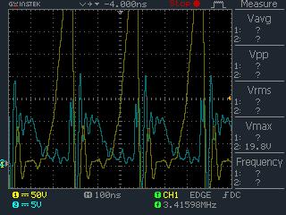

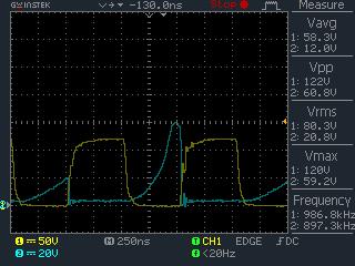

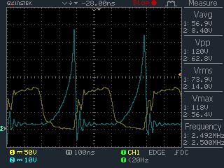

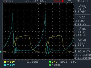

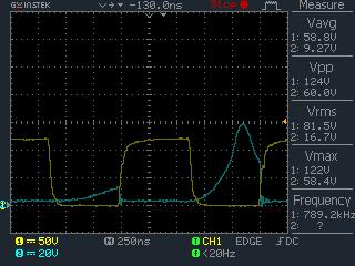

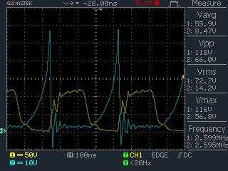

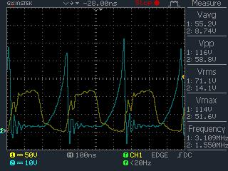

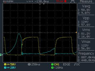

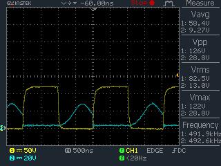

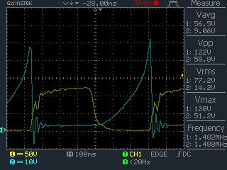

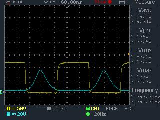

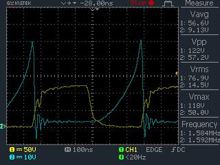

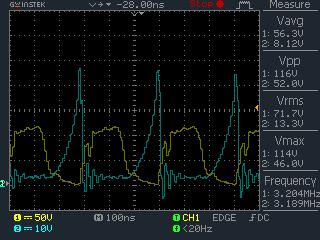

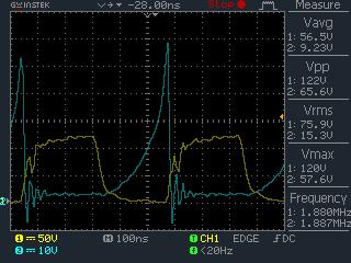

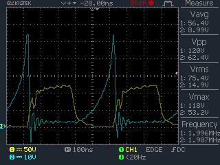

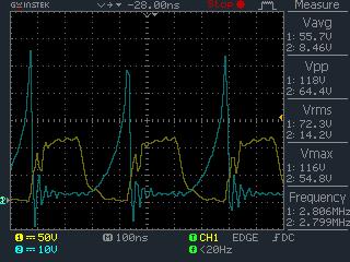

Yes, I tried with difference frequencies and duty cycle (If change the duty also it behave's same manner so I haven't change any duty).. I get the ZVS at 400KHz. But, In simulations I get the 3.4MHz.. So, It has huge difference..

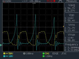

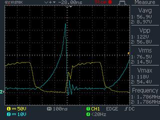

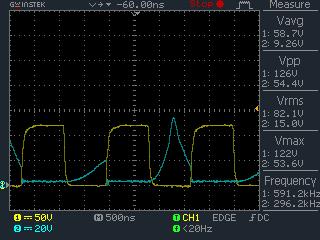

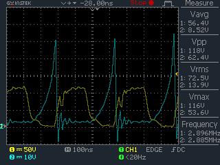

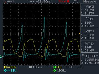

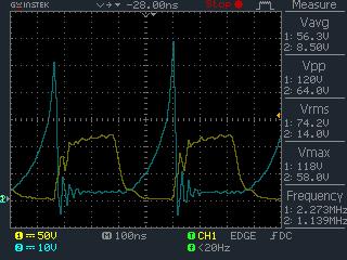

Here, I have attached the waveforms for from 3.5MHz to 400KHz with 50% duty cycle. Here You Go.........
3.5MHz - https://obrazki.elektroda.pl/5504466300_1362055181.jpg
3.4MHz - https://obrazki.elektroda.pl/6221898200_1362055240.jpg
3.3MHz - https://obrazki.elektroda.pl/6306185100_1362055278.jpg

1.8MHz - https://obrazki.elektroda.pl/2960551000_1362055788.jpg
1.7MHz - https://obrazki.elektroda.pl/4292734200_1362055811.jpg

600KHz - https://obrazki.elektroda.pl/7314173500_1362056142.jpg

400KHz - https://obrazki.elektroda.pl/1943809200_1362056203.jpg
So, Please give me the idea how to get the ZVS at 3.4MHz around....
