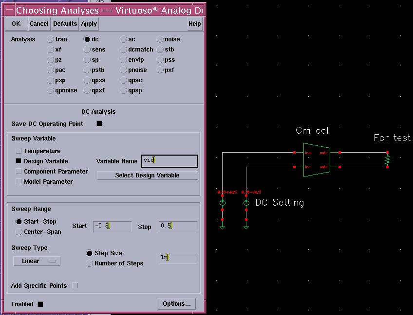

Hi, I attach my simulation method, wish can help u (i use cadence to simulate)
1) change the dc bias voltage to differential : Vbias+Vid/2 and Vbias-Vid/2
2) set the DC analyze shown in picture
3) save the output current
4) run DC simulation, and then use calculator to get deriv Iout/Vin
Then u can get the Gm of the circuit with Input voltage ^^

i try to complete the dc analysis as you told,but i wonder:
vid is a dc signal or a sine wave?
how to get the output current? connect a resistor or a voltage source?
how to use the calculator to get the deriv Iout/Vin?
