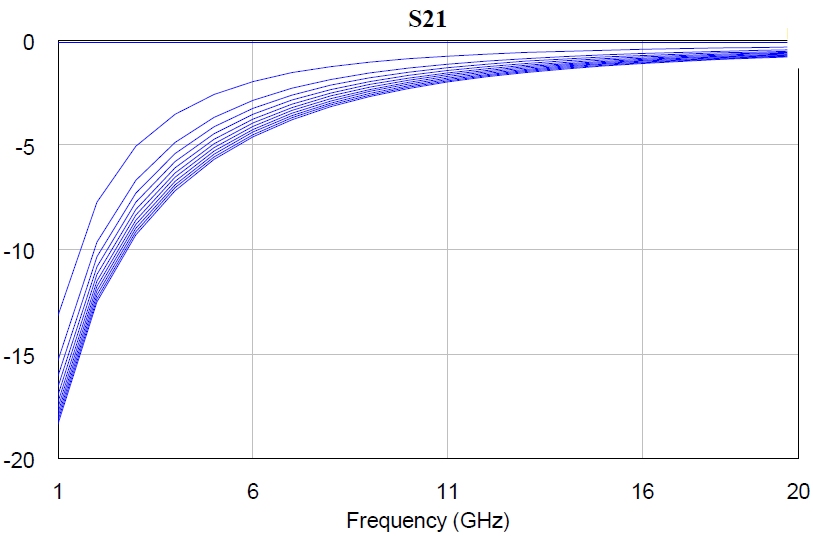

i'm trying to characterize the forward and reverse response of 2 diode models from MWO (PINDD and PIN2) below and above the transit frequency and see that it acts as current controlled resistor at high frequencies.
my question is how to setup the diode as a forward and reverse bias in MWO?
It doesn't make sense to reverse-bias the PIN diode because it will act as almost open circuit.PIN diodes are current controlled resistors as you said and they are generally to implement switch circuit or attenuator circuits. A reverse biased PIN diode will behave a voltage controlled capacitor but capacitor values are generally very low ( depending on diode type ) that's why if the frequency is NOT very high, this reverse biased diode capacitance is generally neglected.
I think your question is referring how to sweep the DC bias supply of the PIN diode.
From the Sources menu chose DC_V power supply and set VStart, VStop and VStep. Also if you want you can chose for a sweep current supply DC_I.
In the Graph menu set the DC_V to plot all traces.
For example for a series single PIN diode varying the DC bias between -10V and +10V you get a plot similar to the one in the image below.

I appreciate your inputs. My application is in switching. I like to have a circuit whose reflection coefficient is 1 or open circuit, with variable angle.
I would have a reversed biased PIN diode and a bank of parallel low value CAPs to vary the phase, as example below;
Diode 1 will be reversed bias permanently, while Diode 2 & 3 can either be open or short.
So my question above how to setup the bias properly in MWO.
