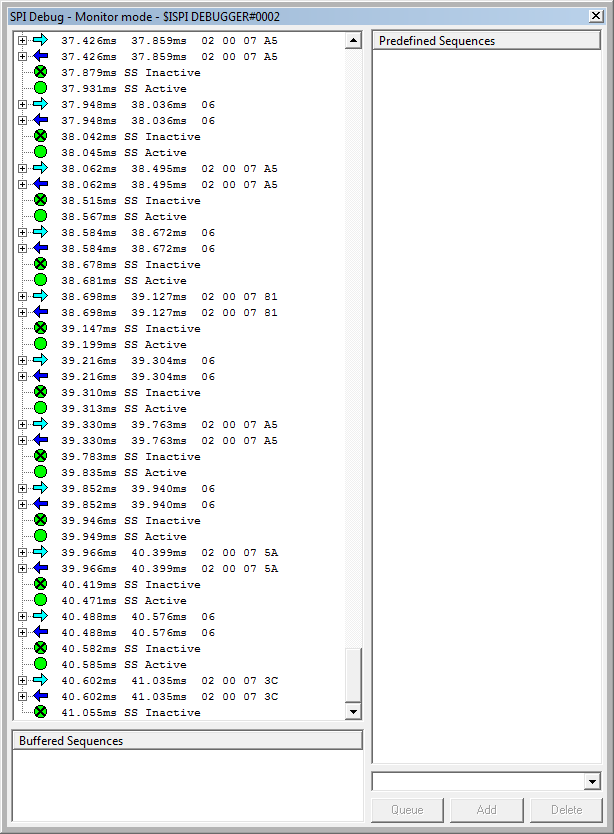

Guys,
How can I see a data being sent into SI pin of 25640?
I want to see data at P3^6 ( byte by byte ), for example I send 1B 2A 3C 4B, how can I see them byte by byte correctly being sent ?
Watch ? capture ? Debug ?
How can I do it with keil / ISIS ?
Thanks
You have i2c debugger in ISIS and software simulator in Keil. In real life you have to use logic analyzer.

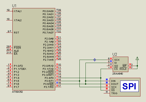

Attach you code and explain what I must to see. I'll try to simulate. Actually, you need only 89c52 model. No crystals, no batteries.
And one important think. All your schematics must have GROUND connection. ISIS don't like floating constructions.

My friend,
The code :

I want to see : unsigned char pattern[8] = {0x3C,0x42,0xA5,0xA5,0x81,0xA5,0x5A,0x3C,};
are being written into 25640 Serial EEPROM,
Can you help with the simulation at ISIS ?
Thanks

I don't have a compiler for c51, so, please, attach HEX programm.
I know many people who buy there. Everything ok.
I attached the hex file, please try,
thanks
  • serial_rw.zip

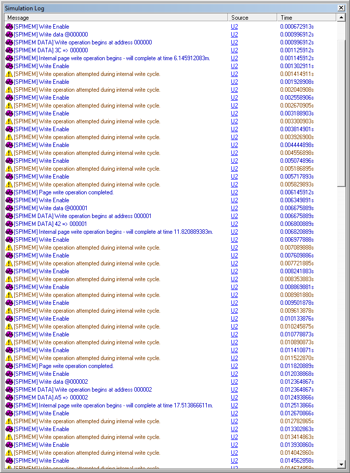

It works, but you have to increase delay for write cycle.
Thanks my friend, where shoud I put the delay in the code ? on the loop when entering the data ? or somewhere else,
there are 3 functions related with writing...
