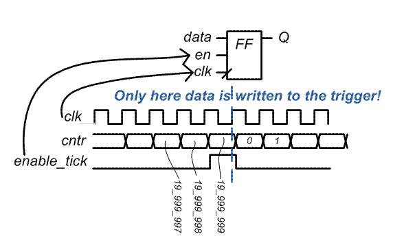

I have to make clock divider from 50MHz to 2.5 Hz. I have no idea how to do it. can someone help me, write the code or explain to me.
Hi! You can create enable ticks for registers in your design which appear with freq 2.5Hz. You need a counter that counts from 0 to 50M/2.5 = 20000000 - 1 = 19_999_999.
In this example module data is written to reg with freq 2.5Hz:
module mymod(clk, data, out);
input clk; // 50MHz
input data;
output reg out;
reg [24:0] cntr; // conter size = log2(20000000-1)
// free-run counter
always@(posedge clk)
if(cntr=19_999_999)
cntr <= 0;
else cntr <= cntr + 1;
wire enable_tick = (cntr == 19_999_999)? 1:0; // create 1 cycle enable ticks with freq 2.5Hz
if(enable_tick)
out <= data;
endmodule
to be honest, I dont understand that code, how it works to divide clock
Try to model it :wink: Do not forget to add a reset input or the following initial block:
initial
begin
cntr=0;
out=0;
end
... otherwise you will get X for cntr and out on waveforms. Take a look at the attached waveform. Enable ticks appear with freq 2.5Hz.
The link you've provided describes not a good way of freq dividing.
Good luck!
