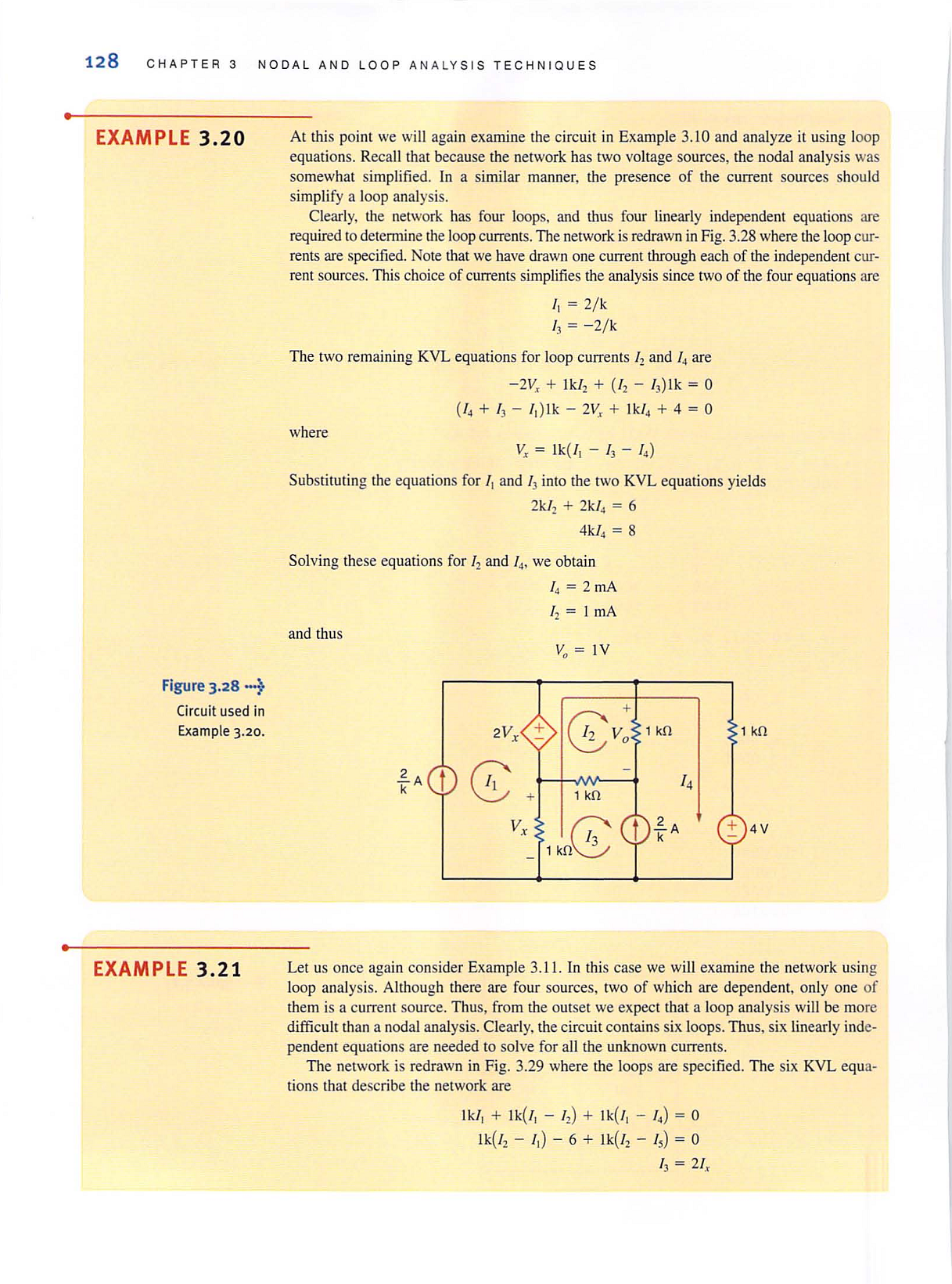

How to implement circuit having dependent source in Proteus?

i am talking about Dependent sources. Voltage controlled voltage source is available in proteus library but i don't know how to use it in the circuit is have posted in my previous post.
Thankx Allen
