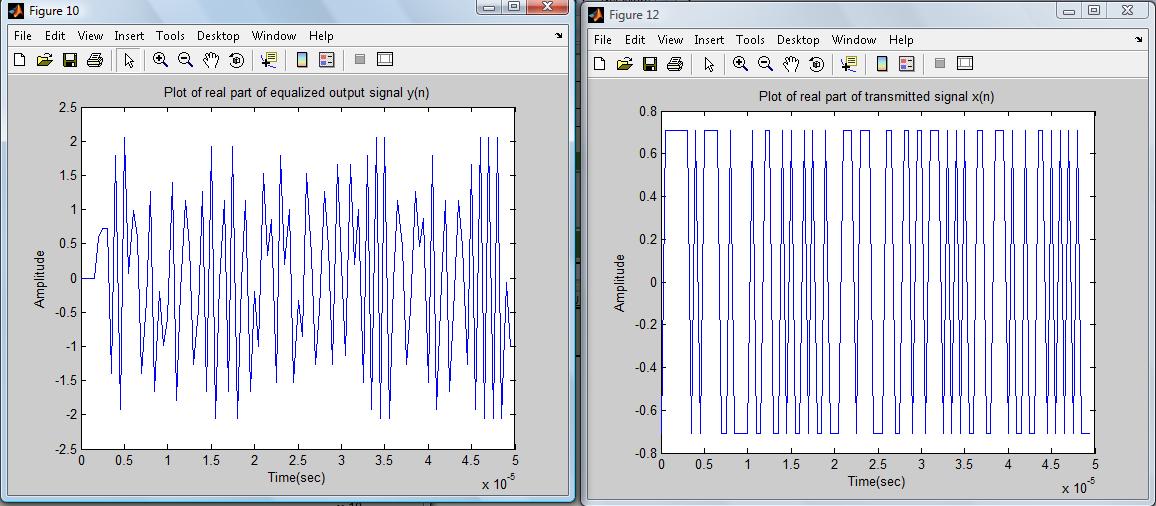

hi.. thanks for the above reply
I have 1 more query....
or
https://obrazki.elektroda.pl/73_1261510530.jpg
i am attaching the plots of the transmitted signal and the received signal after equilization. I believe that both the graphs should almost be same but there is a big difference in both the graphs.
Can you suggest any reasoning for that or are the graphs wrong...
Thanks in advance.
I cannot say much looking at your figures but of course the equalizer will change the waveform!
