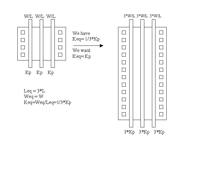

This easy !!!
When you have three transistors in series connected that it common long increased.
But width stay contant!
The circuit we shall convert as equal inverter
Therefore in order to Kp of three transistors became equal Kp eq of one transistor make next
Leq= 3*L Weq = W
see image !!!!
