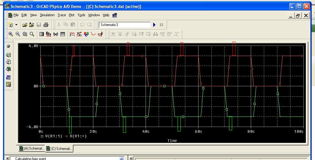

In simple way to say that, I want to generate a square signal with presented of sparse in top of the signal as shown in the red and green color in the image attachment. Please kindly look forward at the image as per attached. I'm able to generated normal square waveform without noise present as input only. It's possible to generated this kind of signal in PSpice?
What you have shown is not random noise but systematic in both amplitude and frequency. You can easily do that by stacking two voltage sources -one with the "correct" signal and the other with the disturbance you want to add. This is what I was expecting you wanted, which would be achieved by transient noise:
Keith

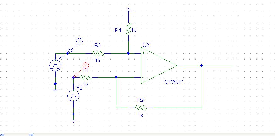

I'm understanding the way you are doing. It's like what I what actually but the problem is I was able to created signal input to non-inverting and inverting pin but how to create distortion signal to this two input pin? My schematic as shown i
You can add signals to any circuit branch you like by series connected voltage sources, either independant stimulus signals or controlled sources injecting the output of an auxilary circuit.
