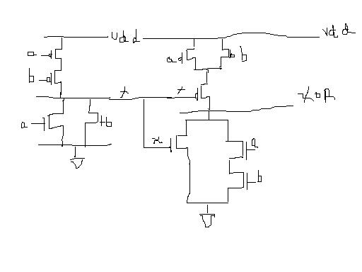

cmos half adder
Dear VLSI technology,
U r asking how to draw a layout of half adder.
Fine u need a layout tool.
u need a transistor level(CMOS level) design of the half adder.
That cmos should be of certain technology.
Then it cmos level transistor should be designed properly like consedering its
parameters such that we should get any violations.
if we get we need to adjust.
If we get certain width, in layout we need to keep the polysilicon area of that width.
then start layout by placing active n- well p diffusion, bulk connection, keep the lenght according to technology and width u designed then connect drain source gate as per requrinment then connect VDD, VSS , then connet onter connection then tap out i/o ports , finally create a abutment box ant if u want place in library place.
hope u understand
