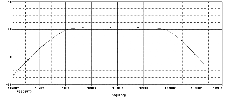

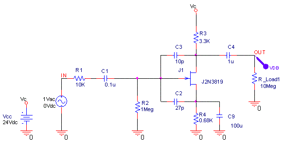

Dear friend
(OrCAD 9.2)
Setting: AC Sweep/Noise.
For example: AC Sweep Type= Logarithmic/Decade
Start Freq=0.1Hz, End Freq=2MegHz, Points/Decade=1000.
Go to Menu bar : PSpice/Markers/Advanced/dB Magnitude of Voltage.
Then put the VDB marker on the output node.
See an example:
Best wishes
