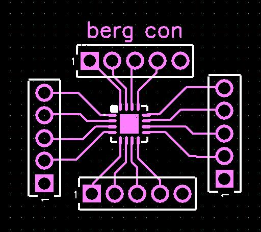

Does any know how to make a test jig that can be used to proble a QFN probe soldered on a PCB?
As the pitch of the QFN chip is about 0.6 mm pitch .. I need to figure out some way to probe some but not all pics of the QFN chip.
will such a setup do? use seperate two pin connector for DC supply and use necessary decoupling capacitors..
