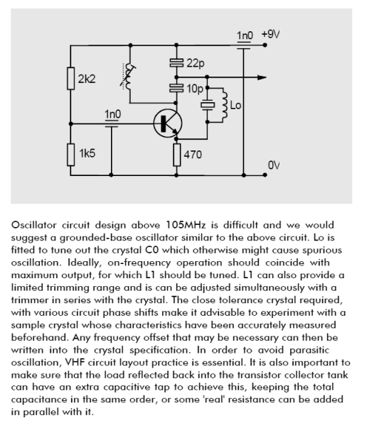

I wan to build a 150MHz OSC with a 50M crystal.
There are several solutions:
1. Amp 50M then filter out 150M (3H) and then amp, too complex.
2. Use a 150M 3H cyrstal, but I don't know hoe to build this circuit?
I knew how to build a fundamental crystal circuit, but no knowledge about 3H osc.
What is the key point of this 3H?
What is the simplest circuit of 3H?
Many thanks.

There are many different circuits for third overtone crystal oscillators that you can easily find on the internet.
But the basic idea, is that the oscillator always has an LC resonant circuit tuned to 150 Mhz, to provide a lot more gain at 150 Mhz than at 50 Mhz.
That forces the crystal to oscillate at its third harmonic.
The max output will be always at the fundamental but if the driver circuit is tuned to the third harmonic, then the feedback gain at the third harmonic will be sufficient to cause oscillation. It has more to do with the driver circuit than the crystal (it must have sufficient output the 3H though)- just you need to choose a crystal that has decent output at the 3rd harmonic.

Thanks, Warpspeed. So I can insert a 150M BPF between Crystal and amp, right?
You won't need a BPF, if you can get the oscillator to oscillate at 150 Mhz, which it should be able to do.
Then 150 Mhz will be the only frequency present.
The output should be a pretty reasonable sine wave, with very little harmonic content above 150 Mhz.
Put it this way, any oscillator oscillates at the frequency where the feedback is greatest. What you need to do is add a tuned circuit tuned to 150 Mhz so that the feedback gain is very low at 50 Mhz, and high at 150 Mhz.
The crystal then resonates at three times the marked frequency and provides an additional gain peak which closely controls the frequency.
