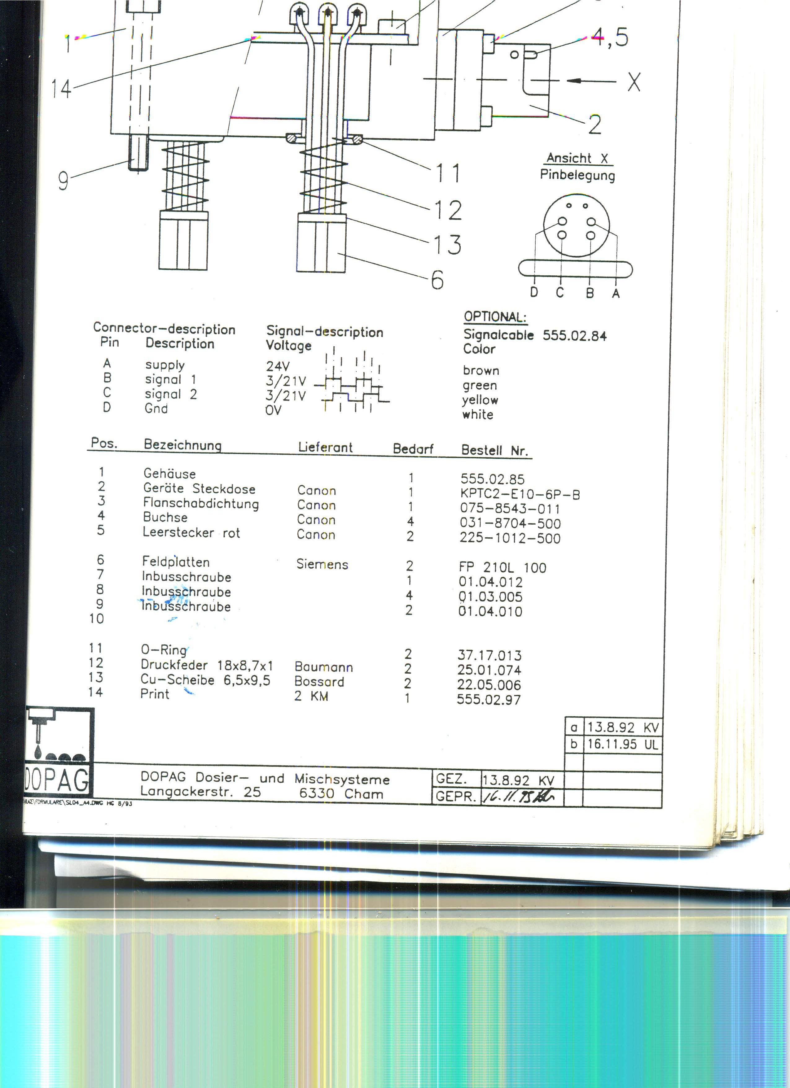

By volume i mean certain volume (ratio) of a glue or mixture that is used in a mixing & metering systems
esp. of DOPAG mixing & metering systems
what to test first ?

Is this device connected to measure volume of flowing liquid ?
That is by measuring velocity (varying) of flow and multiply by area (constant)
1) Is this device connected to measure volume of flowing liquid ? yes
2) i dont think so
2) i dont think so

Can't it be measuring variance of magnetic flux through the flow ? If some one can interpret part names in the diagrams of Post 6; that would be helpful.
what does it mean by " B signal Voltage 3/21 V " ? Esp about 3/21 V ???
What's the difference between 3/21 V of green wire & 3/21 V of yellow wire ?
When it will have nominal signal & when high level signal ?
It's a square wave, alternating between nominal low(3V) and nominal high(21 V) level.
can we measure this accurately by DMM (Dc voltmeter) ?
Why should we? These are essentially 24 V logic signals, the exact voltage level matters in so far that 0/1 should be readable correctly by the connected equipment.
Checking the output operation functionally seems more reasonable. To do it with a DMM, you'll need to make the volume counter operate so slow, that you can see low and high levels over a sufficient long period, e.g. 1 second. Don't know if it can be easily achieved.
Seeing both outputs toggling at higher flow rates would already suggest correct device operation of.
It usually toggling for e.g : 24VDc to 4 Vdc
measured via DMM DC Volts ...... is it right ?
