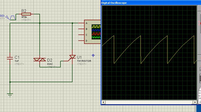

In my humble opinion, a thyristor based sawtooth generator can be expected to use the thyristor itself as bistable component that maintains the oscillation, without additional timing generators or switches.
If we want a linear ramp, the capacitor has to be "charged" by a current source. Essentially, the charging must be below the thyristor holding current. The thyristor can be triggered by a Z-diode, the trigger current must be lower than the charging current.
A typical small thyristor (1 A rated current) NXP BT168 has a holding current of 2 mA and a trigger current of 50 µA (with some type variation). So there's a chance to fulfill the said conditions.
To simplify the circuit, a resistor can be used instead of a current source. If the supply voltage is considerably larger than the ramp maximum (trigger voltage), the ramp will be almost linear.

Here is proteus design file.
  • sawtooth.zip
I downloaded and rechecked. Its working.
Any chance you can port it to multisim?, I'm not quiet familiar with Proteus.
I'm trying this myself but I'm failing once again.
EDIT: I noticed your input signal to be a pulse of 150V not exactly DC ? :s I don't have a problem with that since it hasn't been asked but how to do this in multisim?
I 'm not quiet familiar with Proteus.
Just open with proteus and push run button. Scope will show input and output traces. I dont have mutisim installed on my computer.
Yes, I have the exact output but unfortunately our teachers demand Multisim circuits. Therefor I can not use your circuit as is.
I am glad to see a perfect sawtooth and I'll try to understand your circuit furthermore so I can rebuild it.
If anyone else can help me out with the multisim version? Or another possibility in multisim?

With a trigger transformer on bottom of C1, it's a classical free running stroboscope trigger circuit.
1. Charge a capacitor through a resistor.
2. Thyristors have a breakover voltage, i.e., as the voltage increases, they suddenly start conducting.
3. Connect the thyristor to the capacitor.
4. When the voltage across the capacitor rises above the breakover voltage of the thyristor, it starts conducting and discharges the capacitor.
5. When current less than the holding current flows through the thyristor, it turns off. You'll get a nice saw tooth wave generator with only 3 components. (a few more resistors might be required).
