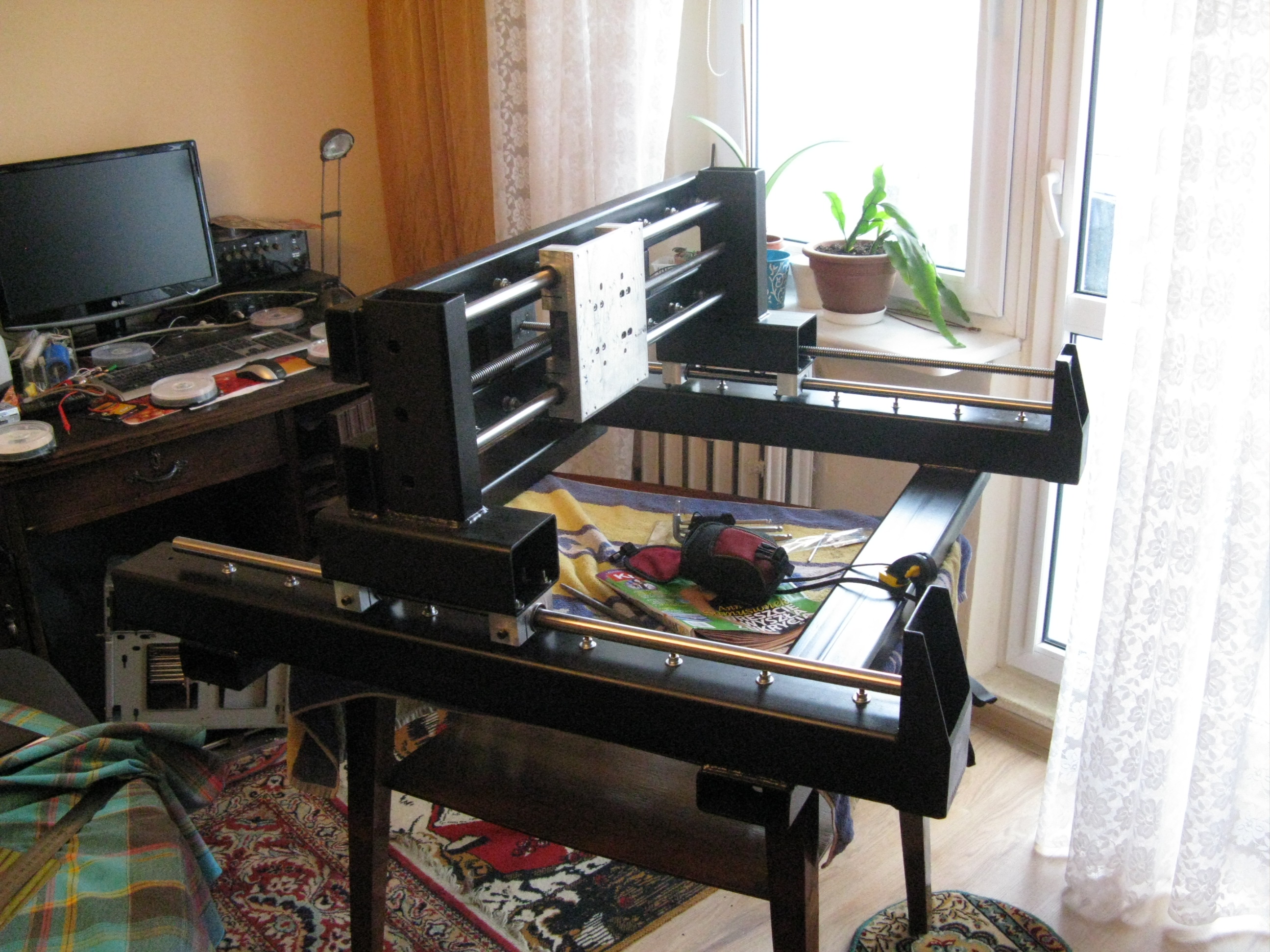

Home made milling machine
Designed for: milling in wood
Type of construction: construction of welded steel profiles 80x100mm, 40x100, 50x100
Working field: 550mm in x-axis, 650mm in y-axis, 130mm in z-axis
Guides: rollers fi20 on x-axis, fi20 on y-axis, fi16 on z-axis

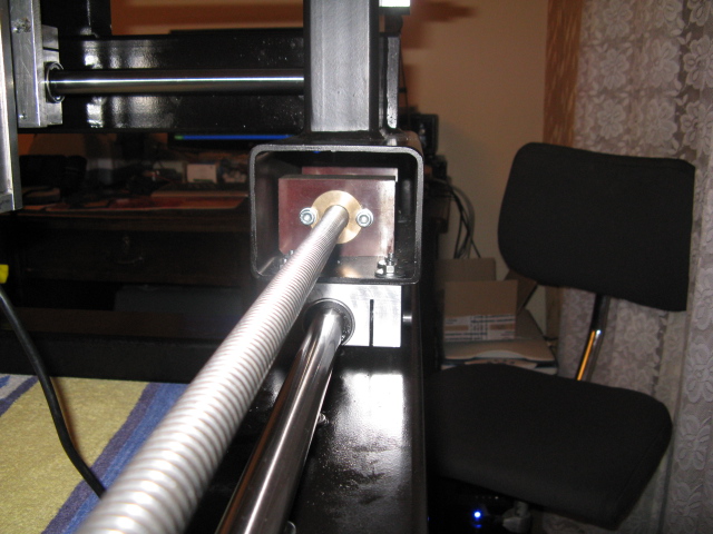

Drive: trapezoidal screw TR18x4, two nuts on one axle
Motors: stepper motors 3x3 Nm

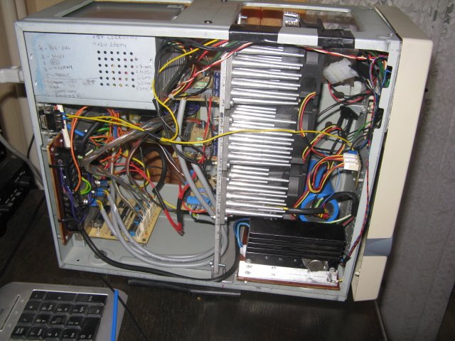

Electronic control: drivers TA8435 LEOO, motherboard OTTOP
Spindle: Budget
Overall dimensions: width 1000mm, height 780mm, depth 1000mm
Weight: about 70kg
And an additional rotation axle.

Motor controllers, power supply, voltage and current indicator:

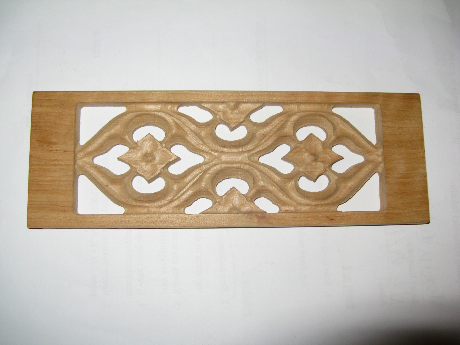

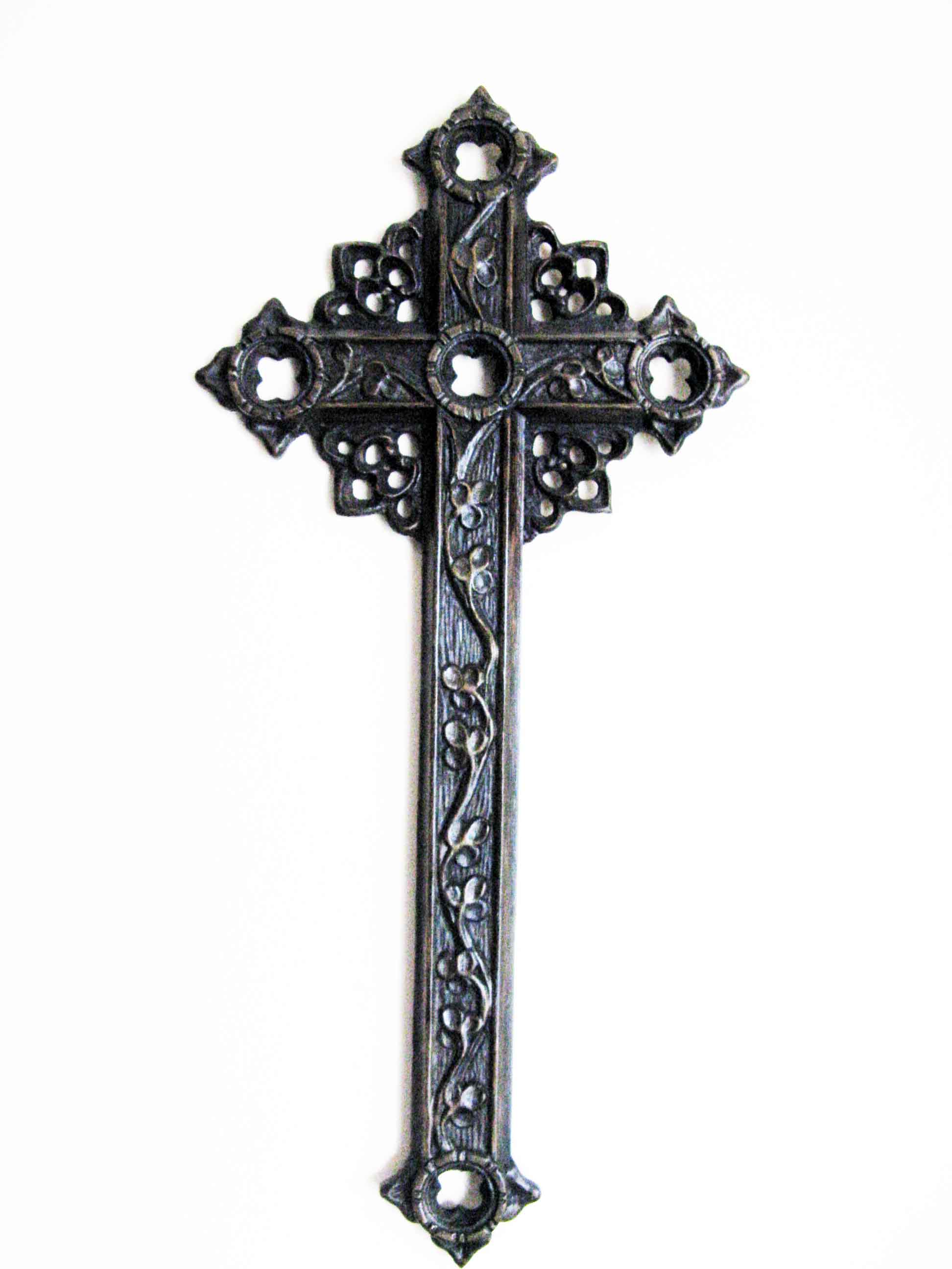

Things made on this machine:

Nice! How do you keep the two lead screws on either side from getting out of sync with each other? Is there a belt or other connection between the two?
