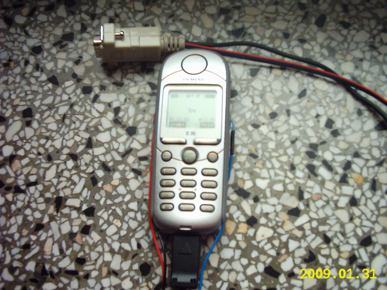

It is a GPS localizer (transmitter) with additional control functions, which can be used in a car. It consists of GPS receiver HI-204III in version for RS232, a cell phone Siemens S35i and the most important – microcontroller Atmega8 with executive circuits. The microcontroller communicates bidirectionally with the phone modem via hardware UART using AT commands, and the GPS receiver is connected to a software UART, communication is only one way – from the GPS to the microcontroller. Executive circuits are single transistors for small currents and double transistors with MOSFET tips for large currents. Executive circuits are used to feed the mass to the fuel pump and LPG solenoid coil, the ON/OFF key of the phone, the sound alarm, the central locking system (closing). One of the transistors enables supply of the GPS receiver. Control is made by the GPS receiver and the ON/OFF key of the phone. It allows automatic system recovery in case of suspension of the receiver and enabling the phone in case of automatic switch off. Proper operation of this function requires turning on the automatic keys blocking in the phone. 5V supply is carried out by means of 12/5V converter based on LM2575. Applying simple linear stabilizer could cause more load of the accumulator of the car and the need for heat dissipation, because the GPS receiver has a fairly high demand for electricity. The phone has a voltage reduction on data lines on resistor and Zener diode 3V6 in each direction.

How it looks inside (the blue element is the GPS receiver):
Phone:
