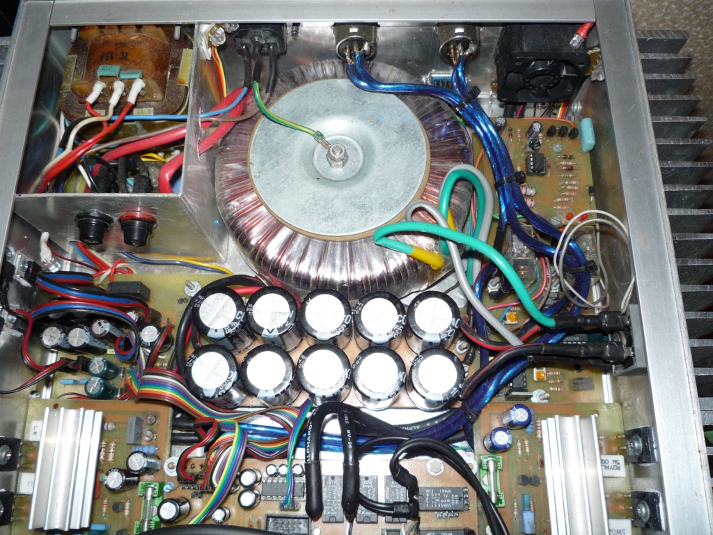

It’s a 2x200W amplifier for small party’s or home audio system. Importand was not only good quality of sound ant power, but also esthetic and durability.
Power supply
Main is a toroid 450VA 2x38V, 5 units of 10 000uF 63V per power rail. At output I have straight voltage 51+/-3V. Standard softstart is 3 resistors 10ohm 15W. to power peripherals I used another transformer 2x18V, 5V, 12V. All part of grid voltage is cover in pod, so as power wire – this allow to minimalism noise problem. Board of power supply is mine project and it consist stabilizers of ancillary’s voltage, condensers, DC protection, overloading protection.

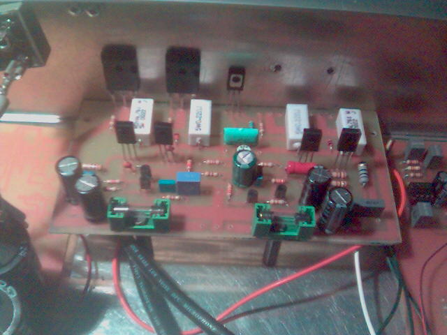

Amplifier
For great power responsible is of course Holton 200.

Preamplifier
Based on popular internet projects. Board is design to my amplifier ( size , shape ). Generally signal is so strong that you provably want use that.
Sound corrector
Standard with low , middle , high.
Cables - audio cables goes upper boards. Microphone's cables in double shield, as short as it's possible. Power wires under boards.
Potentiometer - Alps 100k
