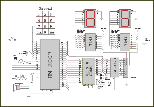

We are using 8051 microcontroller and HM2007 voice recognition IC for our project. We need to interface 8051 microcontroller and the HM2007 voice recognition board. The board has 74LS373 latch IC, which has an 8 pin output. The output is given to the 7448 decoder and also to the input ports of the 8051 microcontroller. When the 7 segment display displays 01, the output port (say P1.0) should be high while the other pins should be low. When the 7 segment displays 02, the output port (say P1.1) should be high while the other pins being low. Similarly this process should happen for the display of 01 to 09 for the output pins (say P1.0 to P1.7). Please help us with the coding.

Is that you are using this kit ???
I am using only 8 outputs. For extra outputs ports can be increased. And yes that is the circuit we are using.
the output pins of latch ic74LS373 is given as input to the ports of 8051 (say P0.0-P0.7). it produces the HEX code (8421) if its output is 00000001 the output pin 1.0 should at high while for other status it should be 0. i m using the output of 8051 ic to control the appliances using driver circuits pls suggest me the programming codes for 8051 using Keil sftware uvision3
you are giving 4 inputs to 8051 or 8 inputs??

#include <REG51.H>
void main()
P2 = 0xFF; // assigning port 2 as input port
while(1)
P1 = 1 << (P2 % 8); // '<<' is shift operator
this all the program you want
its working na but the output pin p1.0 is high even when the output is 0

#include <REG51.H>
void main()
while(1)
if(P2 % 8)
else
P1 = 0;
