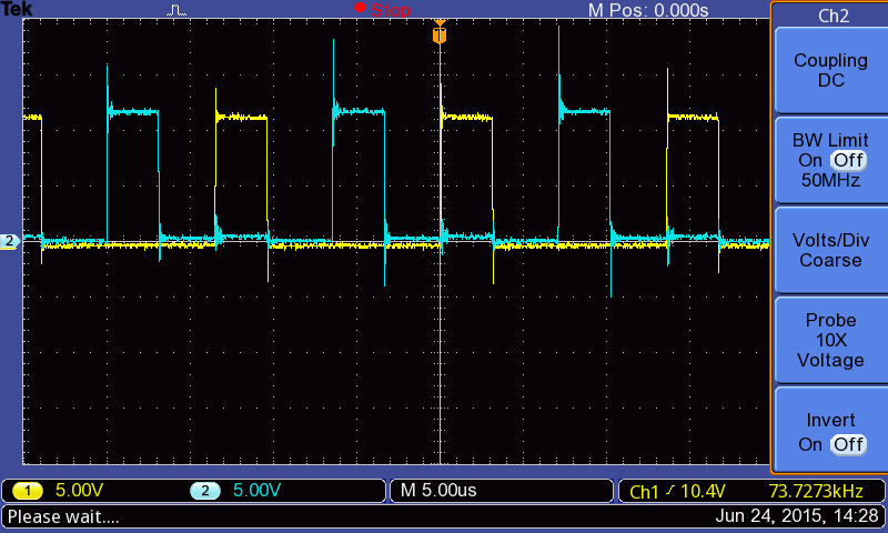

The problem I am facing is as follows.
1) I can see the MOSFET gate driver generate very clean pulses when the MOSFETs are not connected to
the high voltage source. When connecting the high voltage source (+/-200V tried up to 50V initially)

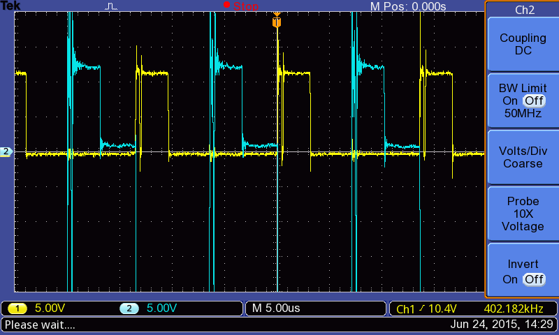

the gate driver wave form get distorted.
the second image shows the waveform getting distorted.
2) With the lower section of the bridge disconnected and no external load connected but only oscilloscope probe connected to the circuit, the upper
section of the bridge, the seems to be behaving strangely. The MOSFET switches on (pull-up) easily but when the pulse signals transition to low
state the output keeps lingering close to Vcc this happens even at low frequency say 100 KHz, The actual switching off can only be seen for very
low frequency signal say 100 Hz other wise for any frequency higher than that the output stays at Vcc.
My assumption was because when the MOSFET is turned on the charge carriers are pulled to create the channel region/inversion layer there needs to be be
some mechanism to remove these charge carriers in order for the channel to disappear and the MOSFET to switch off, this could either happen
over time if the switching frequency is very slow or if there is an external load/dummy resistor connected to the output which would drain this charge.
I was surprised this reasoning seems to be actually true as I connected a 100W incandescent lamp at the out output as load and get the MOSFET to switch up of 10KHz
with reasonable fall times. I guessed with the lower section of the bridge active the pull down would also become fast as there was an active
element(the lower MOSFET) pulling the output low dissipating the charge accumulated making up the channel region.

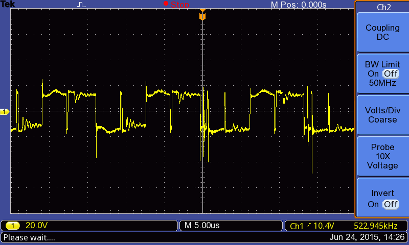

3) With the complete bridge circuit where both lower and higher side of the bridge are connected I am still not seeing a square wave output.
I see a very strange signal output. Image attached. Infact there is thru conduction taking place across the bridge. This happens despite there
being sufficient delay between the pulses being used to trigger the lower and upper MOSFETs making up the bridge. This is further confirmed
as I have safety fuses connected to the supply rail which blow up confirming a thru conduction! In fact I managed to destroy one set of MOSFETs
even before the usual glass cartridge fuse could react!!
Could any one give me some inputs/ suggestions where to look for the problem?

How do you measure the gate driver voltages, e.g. with a differential probe? How can you be sure that the waveforms are real?
I am suspecting that all the circuitry driving the upper FET is getting " blow through" due to the fact that their GND lines have 200V pulses on them and is actually the main load if the output load is only 50 pF.

FVM: "How do you measure the gate driver voltages, e.g. with a differential probe? How can you be sure that the waveforms are real?"
Answer: I don't have access to differential probes, But in my case the 1:1 transformer and individual isolated gate supplies provided
isolation between the power supplies and the oscilloscope. Hence I hooked up the usual tektronix 1/10X probe P2220 between
the MOSFET gate and source and measured the waveform. While writing this reply I just came up with the idea of putting a parallel
dummy resistive load across the gate and then measure the gate waveform again to ensure they are genuine waveform rather than
noisy voltage pickup by oscilloscope probes. I am assuming noise voltages don't have sufficient current driving capability when one
puts the dummy low impedance loads.

You say that you access the gate voltage with a standrad passive oscilloscope probe. This means that either the oscilloscope or the complete circuit power supply most be floating. Large ground currents during switching transients caused by unavoidable circuit capacitances must be expected to ruin the measurement results. I won't trust it at all.
The fact that the main PCB topside has nearly no copper shows that there's much room left for reasonable ground wiring.

Yes the power supply is floating but the scope wasn't. Thanks for the input regarding the usual probes not being good. Apart from the
differential probes is there an alternative means of doing gate measurement. If you check the fairchild application note they too seem to
be using a usual probe with a spring type ground conductor rather than the usual probe with the separate ground cable, I used similar way
to make the measurement, but that is just meant to improve the noise performance.
Another option would be to use both the channel of the and do a channel_A - channel_B trace. Would that be helpful?

To properly measure the gate voltage without differential probes, you should use two single ended probes and subtract their traces. To ensure the results are accurate, the probes should have the exact same ground point, using spring/pigtail ground leads as short as possible, right at the FET source. If you use the probes on the exact same signal, then you should get two identical traces. If you don't, then your results are not going to be accurate.

Try to measure cross conduction problems that will blow one Mosfet and create a guaranteed deadtime worst case load of 0.5us. Or so...with faster turn-off times. Beware XOR gates and opto's are asymmetric in propagation delay which affects deadtime or lack of one as voltage is raised.

Could you re phrase the other bit relating to dV/dt . Essentially this is what is not happening.
I am putting this new scope image. This is just for the high side MOSFET being switched by 70 KHz signal The supply voltage is about 200V. If you notice the
MOSFET turns on multiple times and doesn't remain steadily on. I see the gate drive output too unstable. I was of the opinion that one the gate capacitance
is charged the gate driver would not be supplying any active current to gate other wise there shouldn't be a dip in either the gate driver waveform or the MOSFET output wave form.
