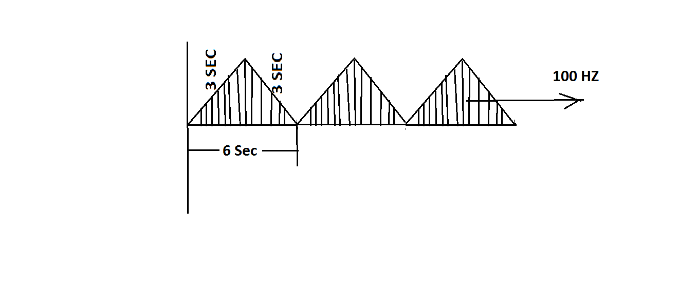

It wold be helpful if you could show a sketch depicting what the waveform should look like.
I was referring to your existing circuit and thought, the connection would be obvious:How i switch (On/Off) triangular wave FvM... Is there any circuit??
Connect the triangle to pin 1 and the 100 Hz square wave to pin 10.
Well, you need a multiplier circuit to do this. You can use any SPDT (Say 1P1G3157QDBVRQ1) and connect square wave to S and B1 with triangle to B2. You should be getting desired output.
Umesh.
In fact, the 4052 is just acting as an analog switch. But you should draw the intended waveform exactly.
If you are searchnig in market, yuo can ask for a analog multiplxer or SPDT. You can order a sample from TI, they are really fast to deliver you the free sample.
^If you are searchnig in market, yuo can ask for a analog multiplxer or SPDT.
If the square wave can be treated as a binary signal (0/1 or -1/+1), an analog switch will be sufficient as a multiplier, as already stated by several contributers.If you want a ramping 100 hz square wave, you will need an analog multiplier, not a digital circuit.
If so, it won't bring up these doubts...the wave form i drawn in my first post is exact
