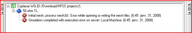

Hi everyone,
I am a newbie in HFSS. My first design met a problem with the mesh as the attached file shows. If you know what the reason is, please help me.
I also tried others available projects, but I still met the same error when analysing.
Thanks

Hi all,
I found out how to fix it ! Use this fix file (1070 B) instead of the old fix file (978 B)
Hope it useful.
